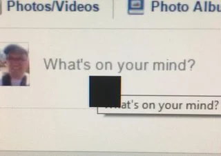

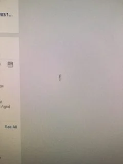

this is what happens to my mouse, probably once a day since getting my RX480.
This ontop of random GPU freezes (pc still works but no screen) since 16.7.3.

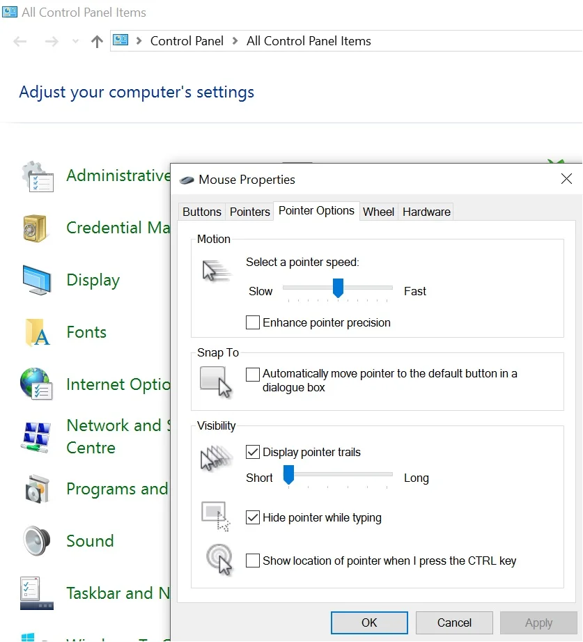

As a temporary solution to this known issue, try enabling short mouse trails.
