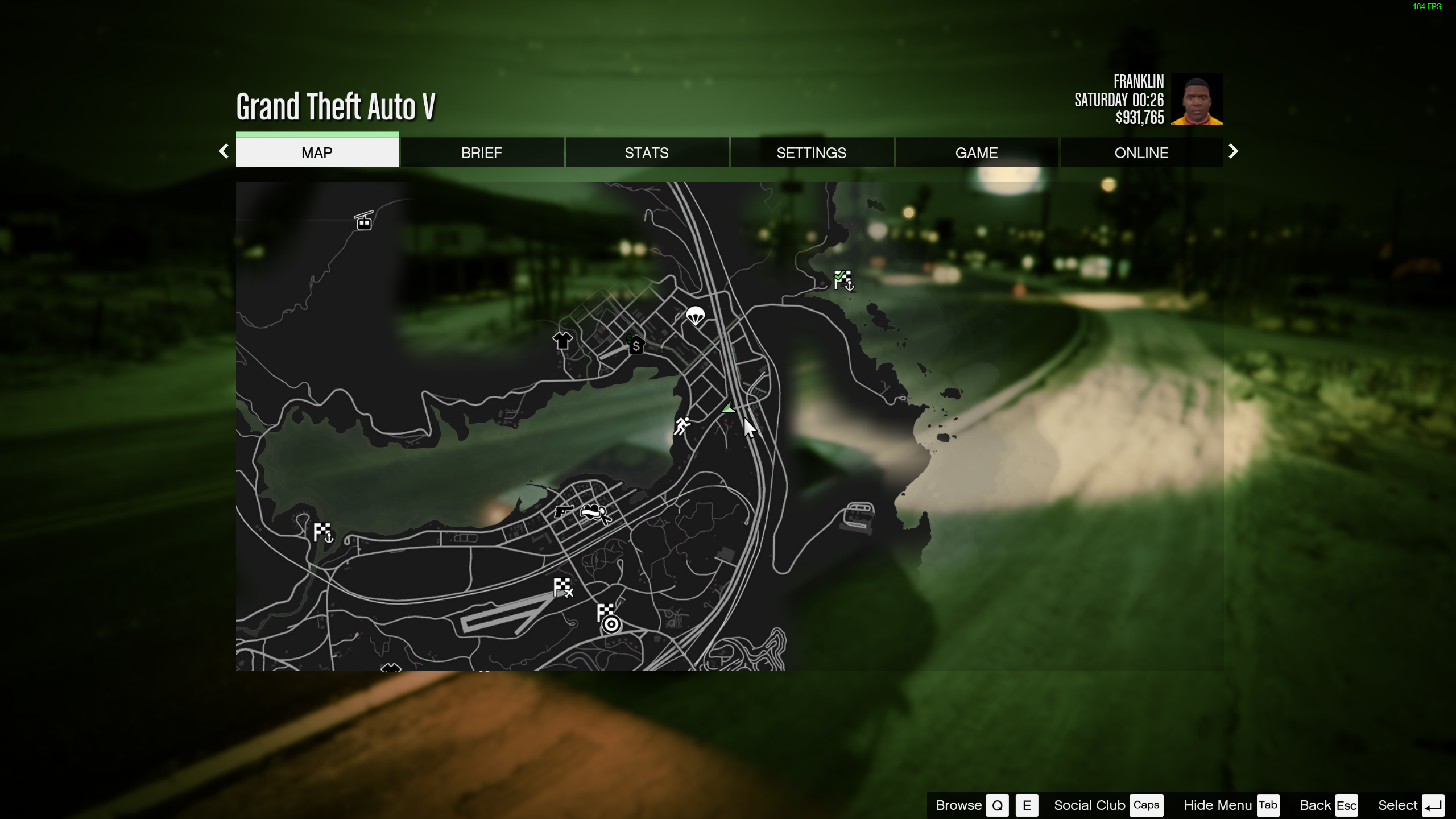

Map location to replicate

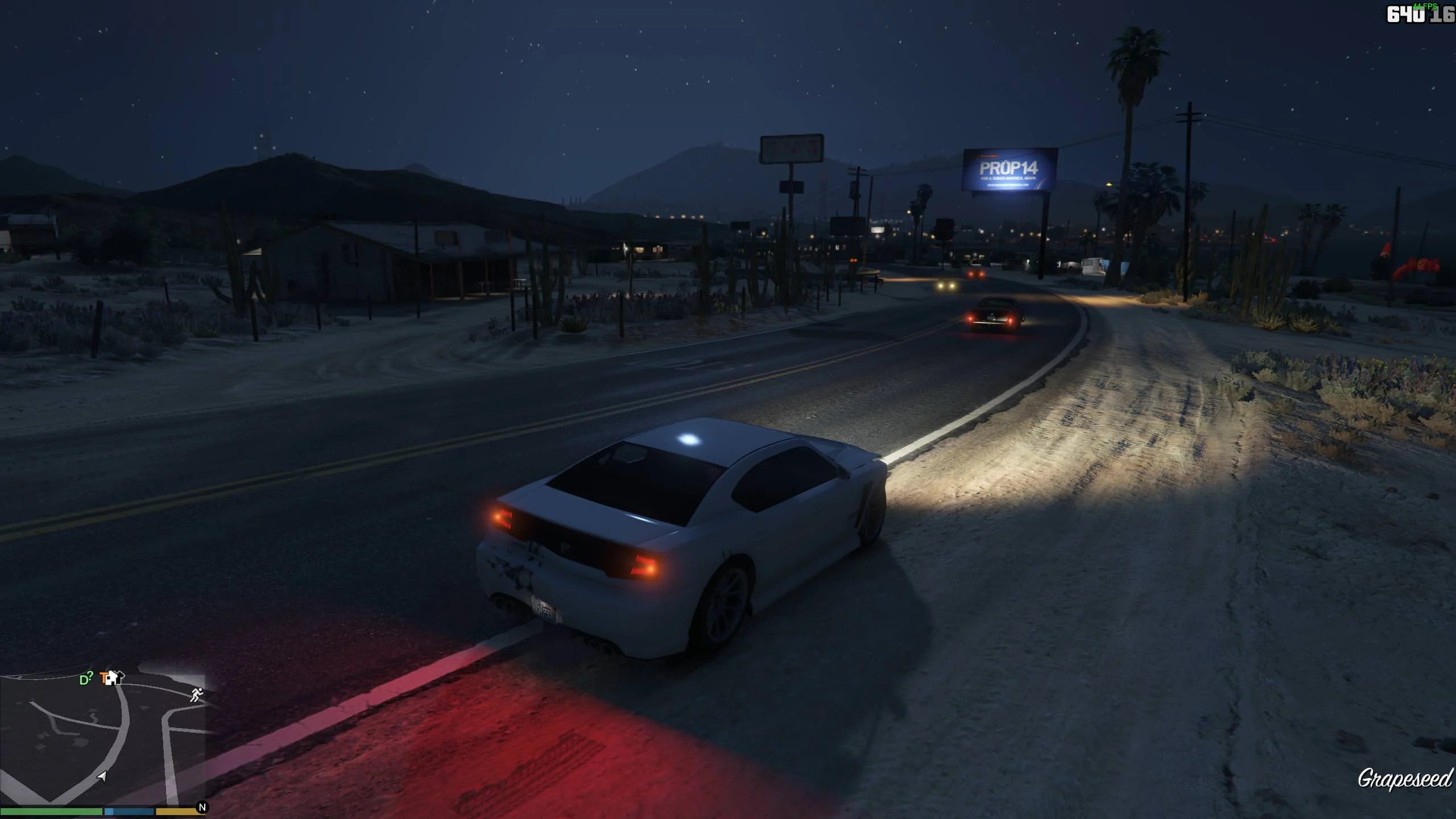

Looking in this direction:
And here:
Card is running hot. 75C is bit much. However GPU utilization is low, 21%!
That's an issue I have seen even on Nvidia cards with Intel CPUs. Hundreds of similar threads.
Reduce your shadows one notch, and remove the side panel of your PC to let the GPU cool down. Seems you do not have enough positive airflow in the case.
