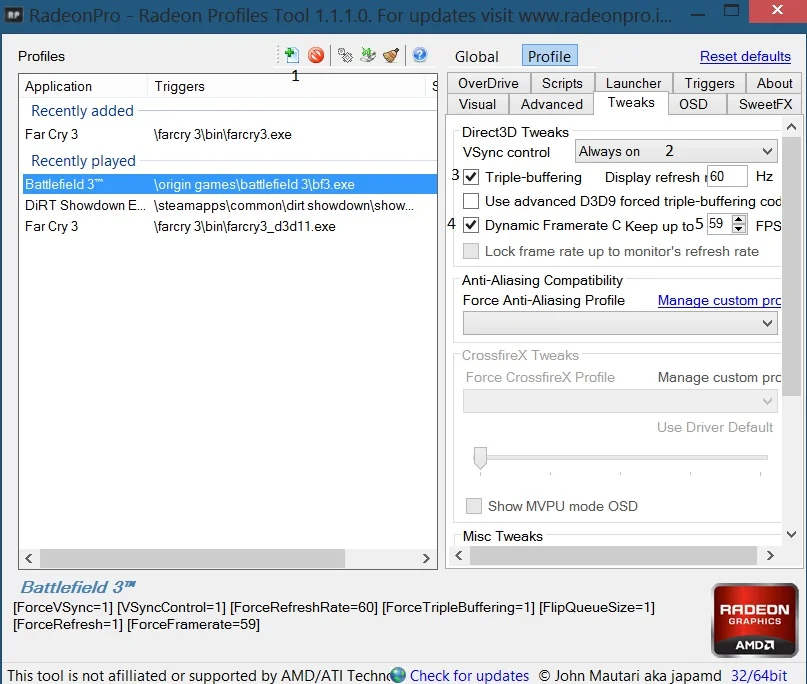

Download RadeonPro
How To Set It Up
Disable vsync and triple buffering in game. Set render ahead to 1 in game. Save and quit the game.
1. Add the game exe to the RadeonPro profile list. Use the farcry3_d3d11.exe FILE!!
2. Change Vsync to always on.
3. Tick Triple Buffering.
4. Tick dynamic frame rate control.
5 Tick lock framerate to monitor refresh rate. - Don't forget to put in your monitors refresh rate in the box above, 60 or 120hz.

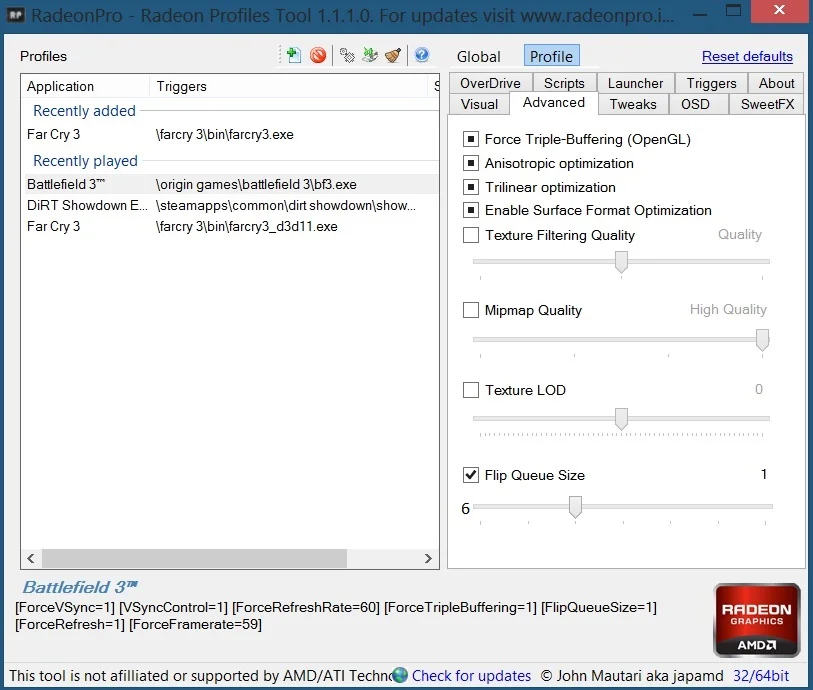

6. Under advanced tick flip que size and change it to 1.
7. Click apply and save. Now launch the game. Smooth??
You are a star as ever LtMatt :D
Rather than using Dynamic frame rate control and limiting to 59fps you can use 'Lock framerate up to monitors refresh rate' instead. Try both and see which one works better. Ensure you can maintain 60fps at all times for smoothest performance.
It is now about a billion times better, thank-you :)
Mouse lag and stutter have gone and it now actually feels like 59fps :)
