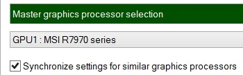

You do have sync multiple gpu settings ticked right?

Yes I have ticked the sync settings for multi gpus.

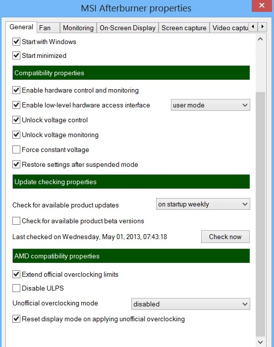

Ok try adding both of these one at a time to afterburner and see if it does anything to help.
Disable ULPS and Force constant voltage. You might need to restart after disabling ULPS.
