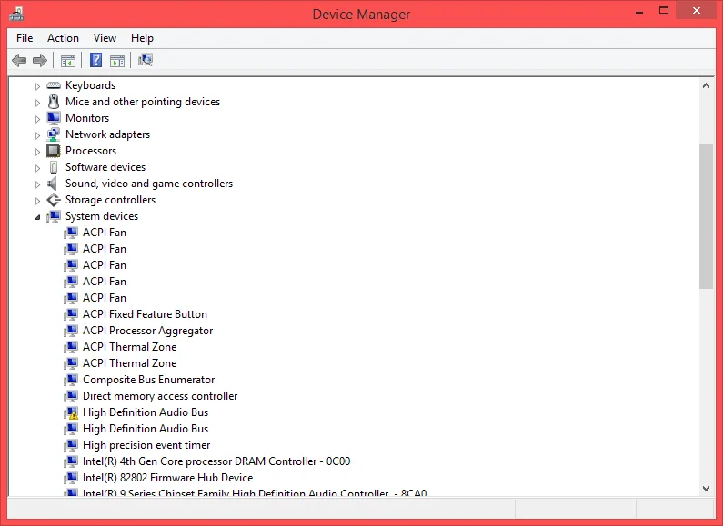

Basically the High Definition Audio controller gets the exclamation mark after installing the drivers, regardless of whether it's 14.4 / 14.7 / 14.9 / 14.9.1
Any ideas or fixes?
^ post install ^
Yup - seen this myself. I believe it's down to ULPS. I got the same issue on my crossfire setup with one of the high def audio controllers, but it goes when you disable ULPS. Suspect it's windows detecting an "issue" with the audio section of the amd cards when it's in standby (or off?)?
Update
I've recently reinstalled my drivers so ULPS was still on. Screen shot of devices with it enabled :-
And after disabling ULPS and rebooting -
It appears it was ULPS, I just reinstalled 14.9.1 followed by afterburner and hadn't updated my afterburner settings.
thank you very much :)
