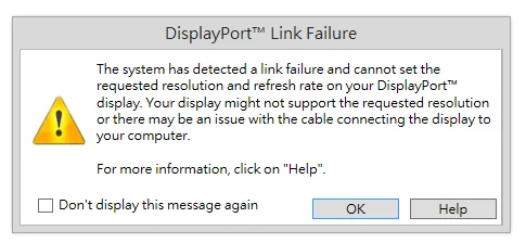

My GPU is R9 290DC2OC.
The brand of cable is bizlink.
The monitor is PB278Q.
If I turn off my monitor's power, the error message will appear.
Does anyone face the problem?
I am not sure whether it is driver or monitor or GPU's problem...
Very Thanks :(
Driver:have tested 14.11、14.9.2....
