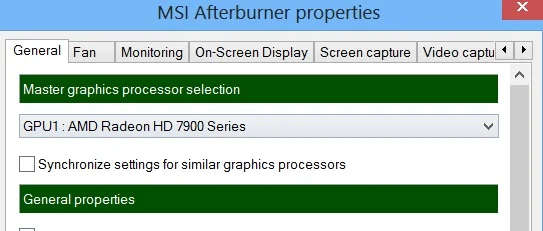

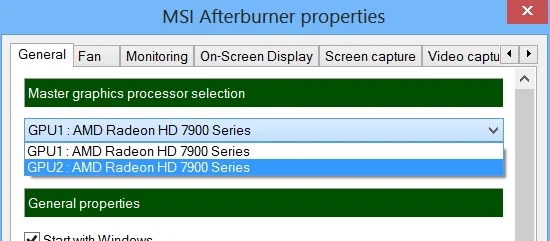

You can use different profiles for different cards if you want. What you need to do is go to settings and untick sync settings for similar cards. Then create a profile for card one, save it to slot 1, then apply. Then go into settings and select card 2 as in the picture below. Then create a clock profile and save it to slot 2, then apply.
I prefer to have them synced though, even if it means i have to give one card a bit more voltage than is needed. But i can understand why you might want to do it, particularly if one card runs hotter than the other.
