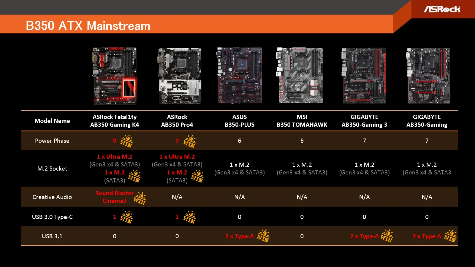

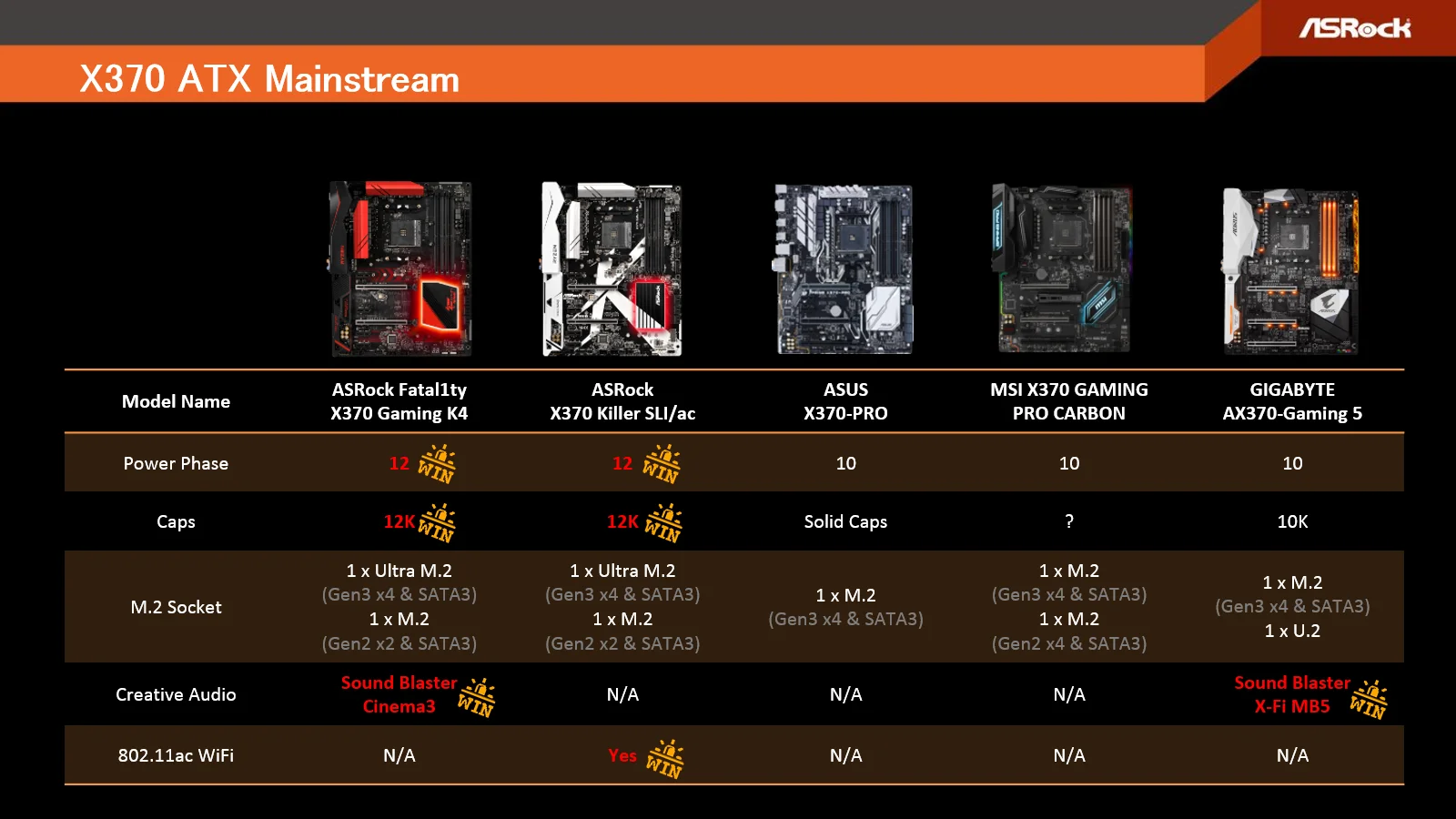

Looking for that image that I think the AsRock rep posted. That showed a list of ASRock AM4 boards and what categories they won in... VRM's etc
Since you asked:
Since you asked:
Just one complaint, the VRM phase count is an issue here. The 9 phases sounds great until you find out that it's a 3 phase on the SOC and a "6" phase on the Vcore. It's not actually a 6 phase, it's a 3 phase with too many components. Ie: two inductors, two low and two high FETs per phase. The reason being is that the ISL95712 voltage controller has two Vcore phase drivers and 1 northbridge phase driver (used for SOC here) integrated into it. The Vcore section of the board only has 1 phase driver on it. Therefore it is not a 6 phase, it's a 3 phase. Due to the voltage controller having integrated phase drivers it is impossible to using a doubling scheme and there are no doublers on the board.
This means advertising as 9 phases is strictly incorrect, there are exactly 6 phases on the board, 3 for SOC and 3 for Vcore. It just looks like a 6 phase due to having extra components.
All this is taken directly from this video and have looked at the data sheet for the ISL97512 and have confirmed that this is the case. A 6 phase Vcore with it is not possible.
Now I understand that it will power these CPUs just fine especially the R5 and below CPUs. There is no real problem with the power delivery just the advertising which seems intentionally misleading and intended for pictures like these^^ to make it look better. Advertise it in a way that makes dual FETs sound really good but don't claim the board has 9 phases.
It's not unlikely that this is a mistake where someone's equalled chokes to phases. Like you say, it's a 3-phase system with dual chokes, and we hadn't given it much thought before you brought it up. We'll forward this to HQ.
It is completely fine for all current CPUs though, and these lower-end boards with this VRM design aren't designed with overclocking in mind.
