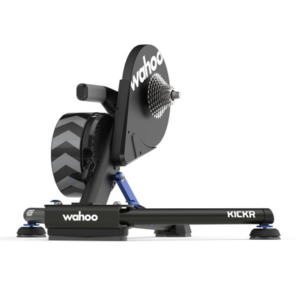

Here's a video of the noise from my Kickr
I suspect it's not quite right, but wondering if anyone has experienced anything similar. Compared to the previous night, gear changes were smooth so unsure if the RD had taken a knock but had then "settled" with riding a little.
There's a few noises of concern in my head
1 - Right at the start a kind of grinding noise
2 - When coasting (around 10 secs in), almost like a wharbling noise (is that a word?)
EDIT - Everything on the Wahoo site seems to be blaming word chains/bike setup, but i took the bike off and rode around outside and had no issues.

It can’t be gearing/chain if it happens without pedalling. Bearings on the trainer worn?
This is significantly louder than my kickr snap used to be so there must be something wrong.
Yeah, i'm thinking bearings too. Not something i've ever dealt with before so will do some reading on it. Have also messaged the seller to get his thoughts as he deals in a lot of them.
Winning. There’s a bearings place about 5 minutes from me. Popped in at dinner and then swapped them over this evening.
It’s now silent. Although there’s a spacer I only found when I’d put everything back together so that’s a job for another day!
Can’t argue for £5 worth of parts.

Yeah, just 2 flywheel bearings - 6003 RSC3. There are some other smaller bearings but they all seem fine and are apparently a bit more stubborn.
General guide here, it was certainly easier than i'd expected.
Since the above fix was successful, this was the seller i bought from. Considering they're the V4 unit, it seems a decent price and a few sell around the £190 mark
God Dammit!
Took the Kickr apart again last night to fit the spacer back in, put it all back together and then found a rogue washer. Took it all apart a third time, only for the parallel key pin thing to ping out and be eternally lost.
I now need to wait for the one i ordered to be delivered.
On the plus side, i am now an expert at dismantling the Wahoo Kickr (maybe less so at putting it back together!) :D
Good to share your steps, if you took photos. That site is good, but he doesn't display any real method with pictures - people doing this sort of thing will generally follow it by pictures...
God Dammit!
Lol that's the key pin thing and why is it tensioned that much? The tensioner/pully should be carrying any tension in the system...
I enjoyed taking my FLUX and Neo apart multiple times, but both very much out of warranty... Going to hold off doing anything unnecessary with the KICKR - at least for the first 2 years while it's under warranty! ;)
One thing I'd say - in that guide he talks about using that aerospace protectant 303 spray on the belt. I'd be cautious as that reads like it's for protecting from UV and keeping the surface clean. UV is no consideration for this hidden component. The anti-dust may work, but a better solution would be a 'belt dressing' specifically made for the job - it'll likely preserve the belt better, while also stopping more noise/slip.
