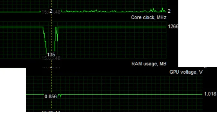

Something is going on.
When I have any window open, Anything, the clock sticks at 1266 MHz, even with my OC....
GPU Z reports a clock speed of 1366 Mhz, however in sensors, it is 1266 MHz
If I only have desktop the clock drops to 135 Mhz and voltage to .856
This is the suspected drop in voltage that may cause the D3D crashes....
I don't ever remember it sticking at base clock when idling...
Howwver I may be wrong
