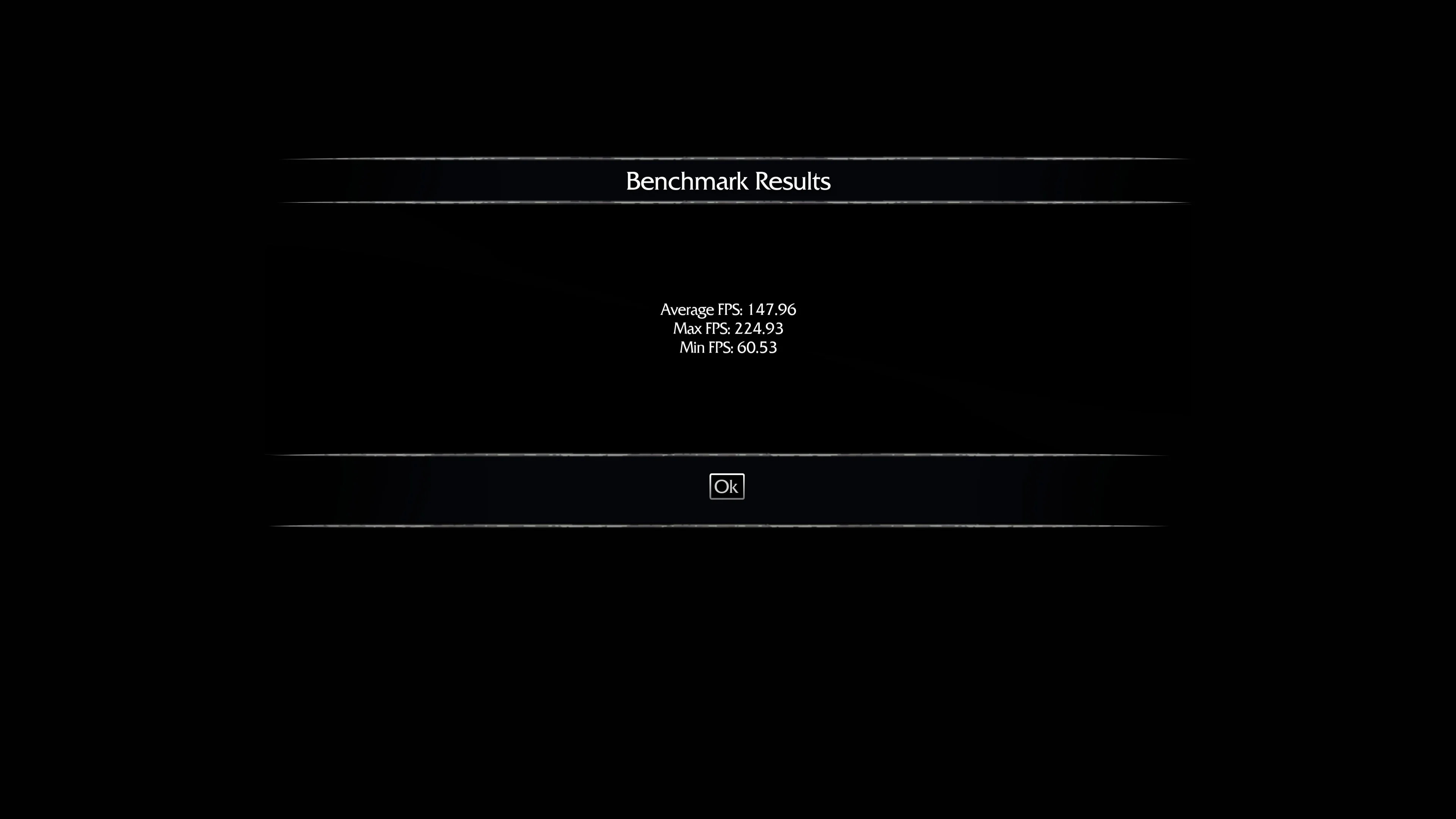

Drivers are getting better for Middle Earth
2160p Maxed
