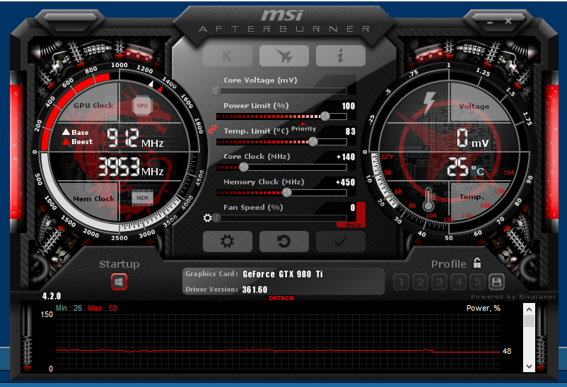

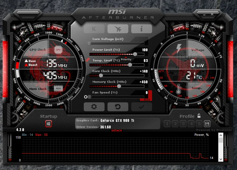

Yer, looks about right and I couldn't remember the clocks from when I was multi mon. I understand that the extra power is needed as you are running 2 screens but I am sure they could get it down to less but it is the same for AMD, so no good for either really. The extra power draw will mean pennies on your bill though, so I wouldn't worry about it.

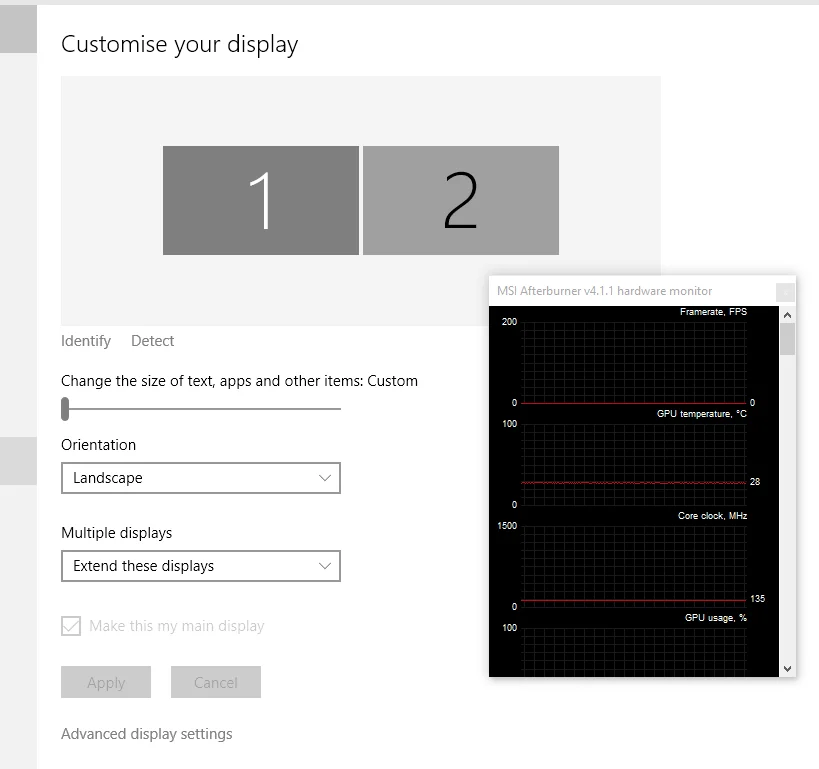

could it be because the monitors aren't the same?
One is a Asus 120hz and the other is a Dell 144hz Gsync.
When I disable one monitor clocks go back to normal.
Mine are TV and 144Hz G-Sync@1080p.
I don't know much about why other than idle clocks have been bugged for some, just showing that mine don't and not noticed that they ever have clocked up on my 970.

ok this is strange
When the main monitor (Dell) matches the refresh rate or is lower than the Asus (120hz) then it downclocks. When I put it on 144hz again then it increases.
It's a bug.
