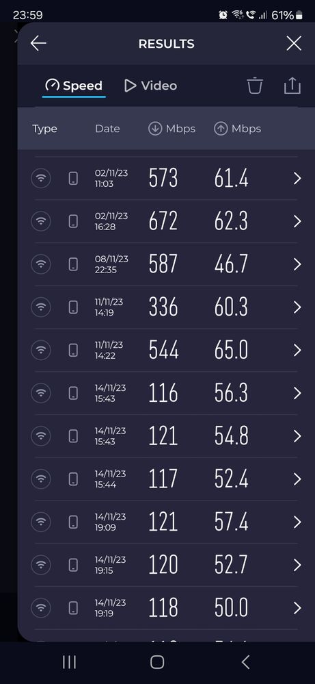

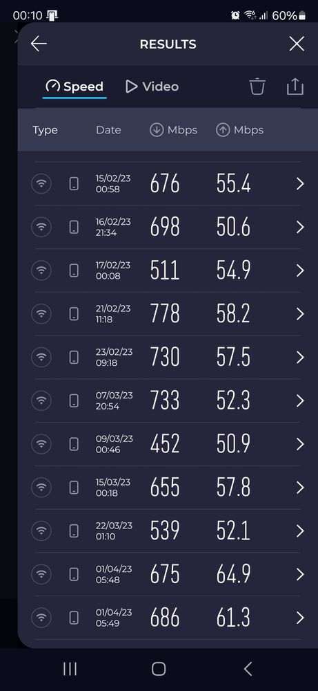

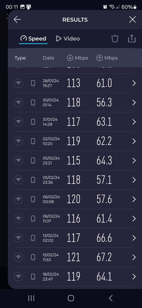

A further update to this - I made three send me out a brand new replacement router, so I could rule out that being an issue. I have a new router, new sim card, and nothing changed. exactly the same stuck at 120mbps. You can clearly see in the screenshot below of my speed tests, the moment they made the changes at their end on the 14/11/23, and from this point on my speed has been throttled to 120mbps. I have also added a screenshot of speed tests from Feb 2023, compared to speed tests from Feb 2024 and the differences are striking. My speed used to vary, as non throttled speeds should between 400mbps up to 900mbps depending on the time of day as you would expect. Now, my download speeds have no variation at all, 7pm on Saturday evening at peak times, 120mpbs, 3am on a Sunday at the quietest time, 120mbps.

Speed Tests showing the dramatic drop in speeds the day Three changed the settings on my account at their end, and from this day forward (14/11/23), I am now stuck on 120mbps.
Speed Tests from Feb 2023 when my download speeds were not being limited and extremely impressive!
Speed tests from Jan/Feb 24 showing download speeds limited to 120mbps, up to 6 times slower than they were 1 year ago!
