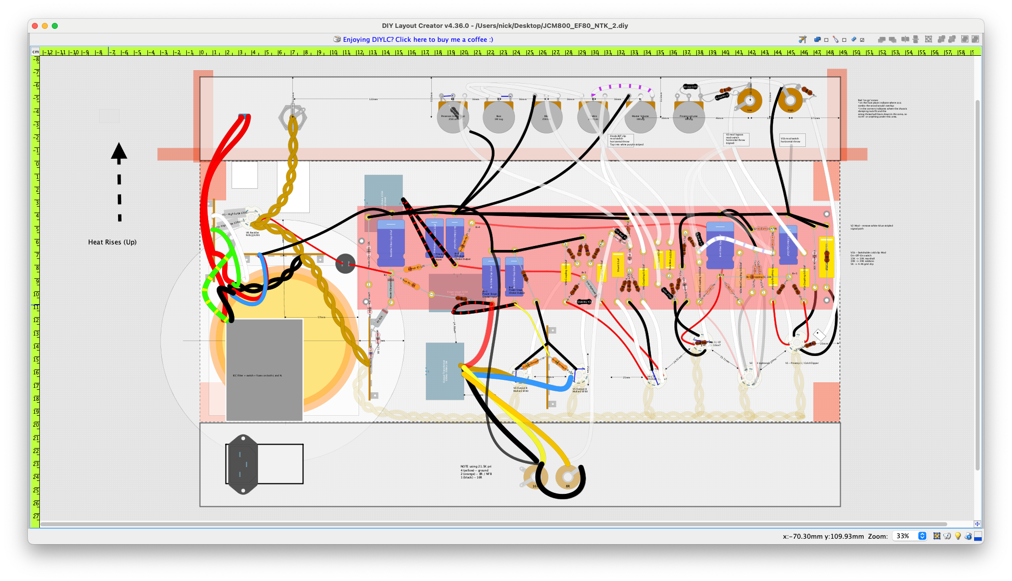

So this is the current proposed final layout of the new amp.
There's a couple of issues I'm looking at how best to solve - you don't know until you've built it:
1) the output transformer is quite weak in the low frequency range, couple that with a 16R speaker and it could be quite thin sounding, there's a number of ways to solve this :D The original JCM800 50W speaker OT had quite a flat response plus then the EL34s had quite a kick that gives the UK JCM800 (EL34s rather than 6550s in the states) it's characteristic hard hitting thump.
2) I'm using the 240V primary so when I plug in my 230V mains (which is at the top of the +10% range) my 253V wall voltage pushes the all the voltages up by 5%. I can burn this off with resistors etc but the power transformer is rather hardcore (139VA - basically 130W power supply) for it.. it could run a 25W amp quite easily.. We'll have to see.

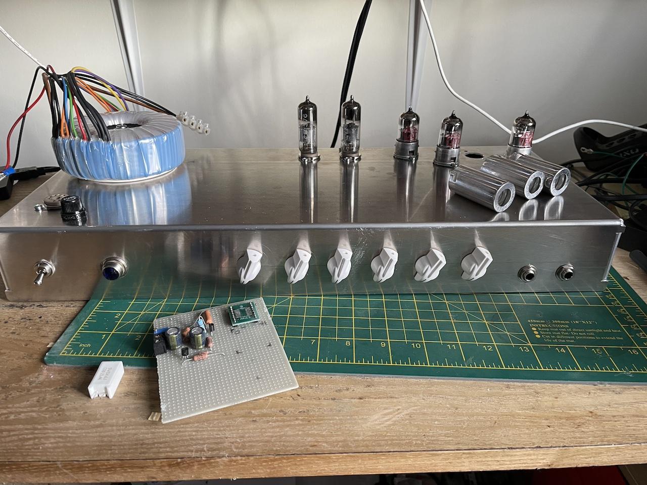

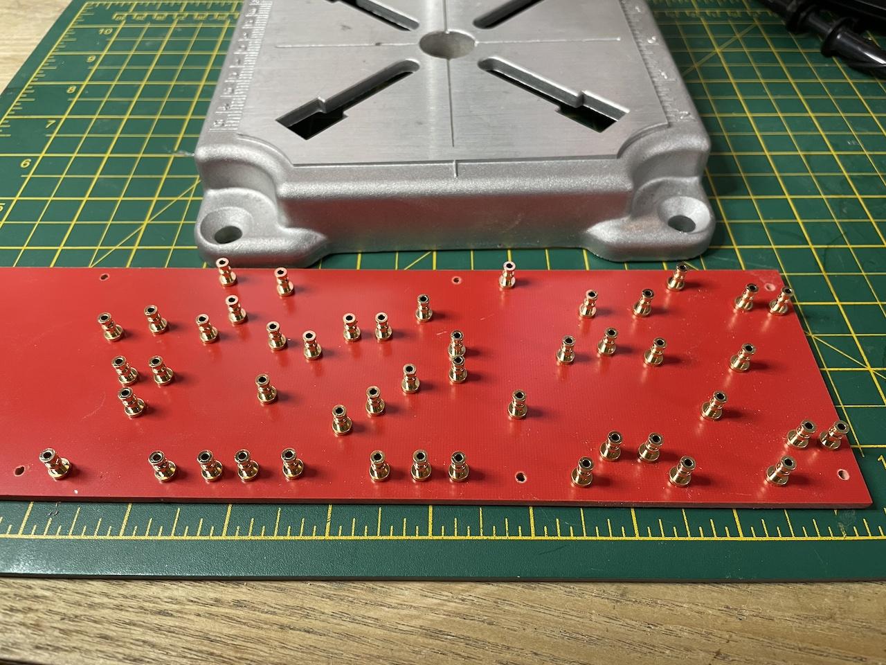

I finished the main board, but I need some more components and missed 4k7 resistor yesterday..
Today... I had a little chassis time - this means I can crack on with the internals of the amp whilst the other components ship.
Little tubes to the right are the 12ax7 pre-amp tubes.. just the same as a regular Marshall amp plus one for the infamous Mr Scary V2 mod making it a 5 gain stage amp (you will be able to switch on/bypass this from the front). The two centre tubes are the little output EF80s pentodes that will push a hellish 1-2Watts :D (This will be loud enough and some!).
So:
a) the front is offset to work in a combo amp or a head.. plus there will be switches above the sockets.
b) V2 mod tube socket hole at the back (making it a 5 gain stage amp .. attenuated as it's to adjust the waveform rather than add gain.
c) rectifier will sit at the front next to the HT fuse.
d) the power transformer will get flipped at some point and then I'll confirm the positions of the output transformer and some power smoothing chokes.
Oh.. importantly it has a purple power light (I thought it was blue initially looking through it but powered it's purple :D).

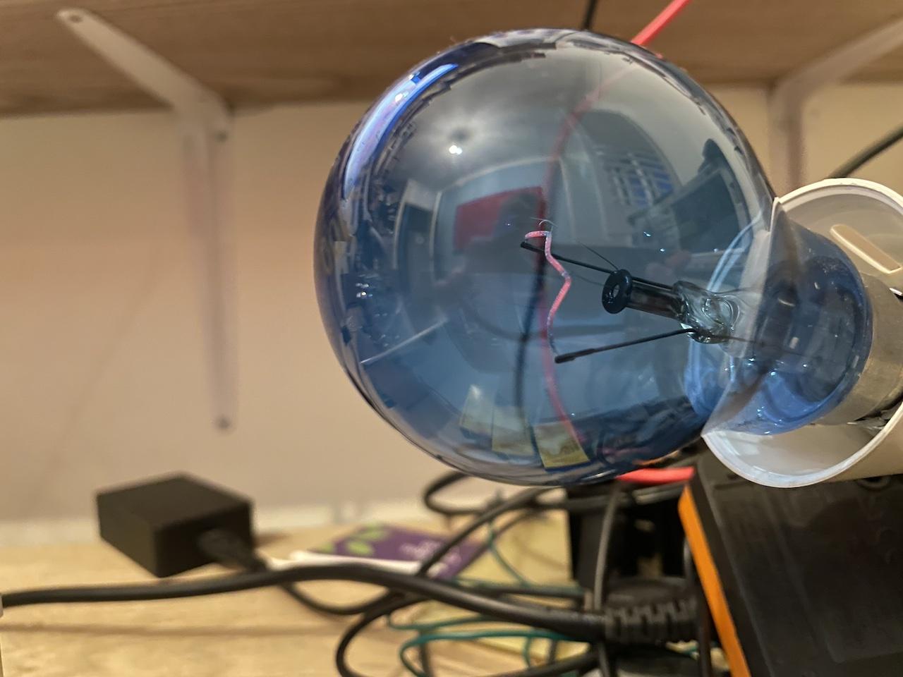

When starting an amp up, it's a good idea to use a bulb in series with the amp to detect and limit current draw from the amp. Incase there's any shorts etc.

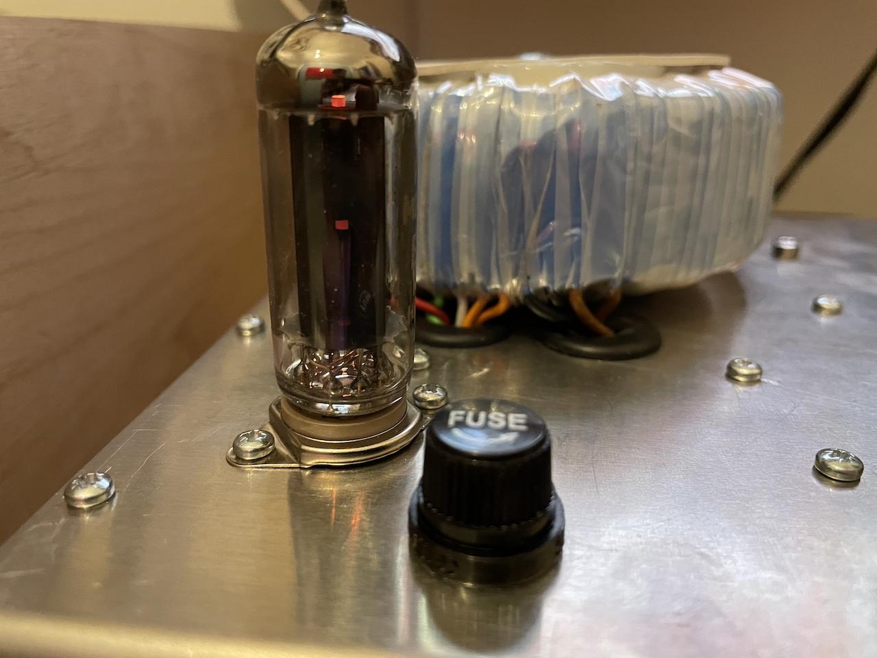

The 1957 EZ80 rectifier tube I have seems to happy.. it's heaters glowing but not red plating (sign of drawing too much current).

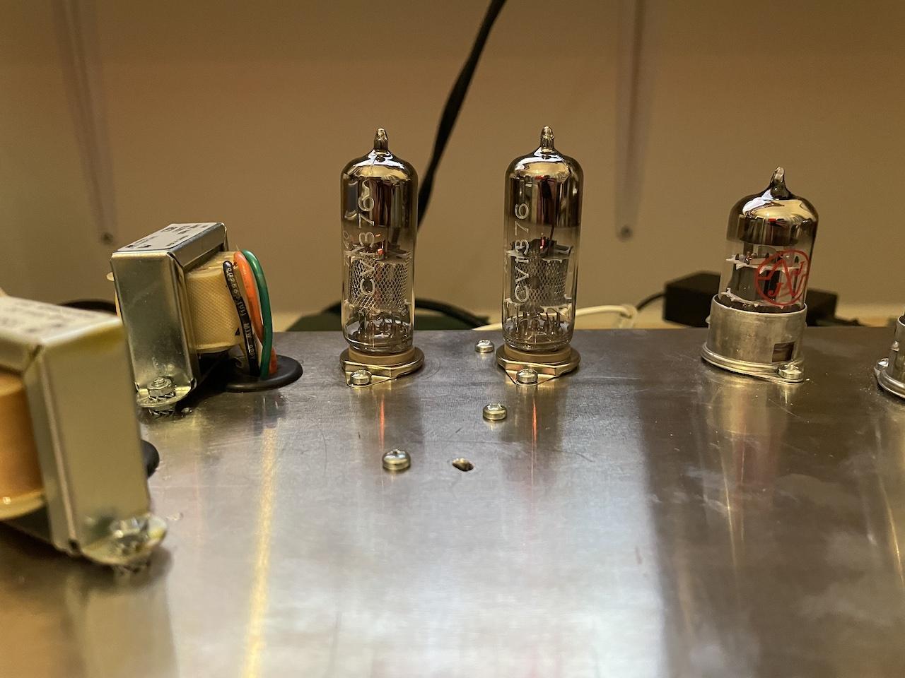

Next is the EF80 power tubes.. the heaters glowing but no red plating either.

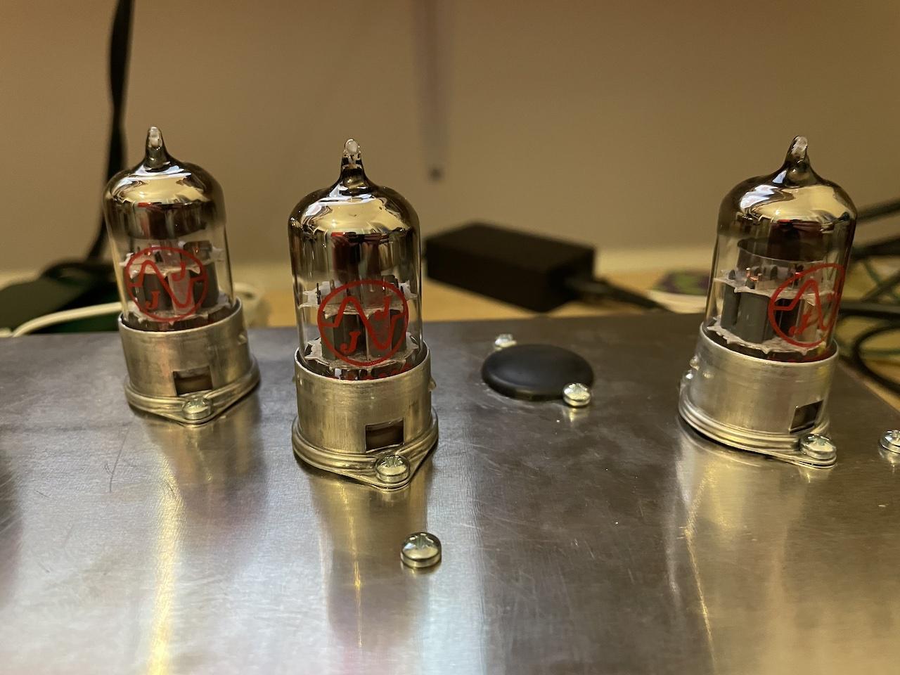

And finally the 12ax7 preamp tubes.. heaters glowing..
So all in all a pretty uneventful startup after checking thoroughly and then cleaning up the inside from any solder 'sparklies' that could cause a short.
