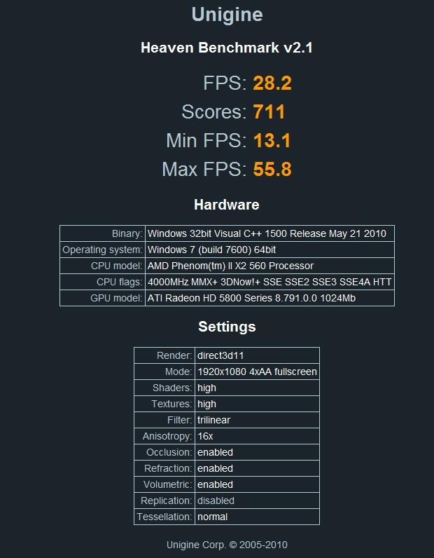

Heres mine.. this is 1920x1080, with 4xAA with 950 core and 1250 memory...
And heres Marine-RX179's score with 1000core and 1300 memory at 1920x1080p...
I know the resolution your running is a little lower but no way, your claiming faster than 6950 speeds with only a slight lower resolution...
