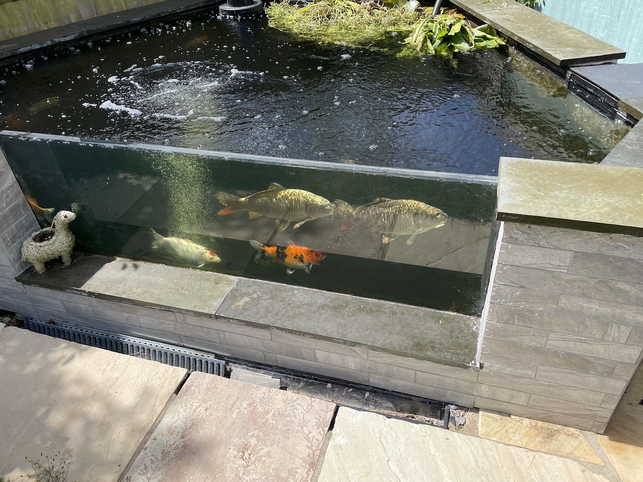

As the outlaws are over, we had a little trip and ended up with two smallish additional Koi - Marco (black and white Kumonryu) & Polo (Asagi) - as named by the kids.
Both seem to be doing well - Marco is looking at the Rin Gin koi going "that's a big fish" but didn't seem too stressed, and Polo has been following the mature fish and stuffing itself now it doesn't have hundreds of other fish to compete against.
Photos to follow once they've settled down.
Now that really is the last koi purchases.
Currently uploading..
I noted that one of the large fish has clocked itself against something straight edged - so that could be brick but I will keep an eye on that. I suspect flukes. Only issue is we've got messed up weather here with some storms/rain which may also be part of the issue. problem is I'm not going to be able to catch this to treat it, easily. Human is tolerated, Human with net.. nope.
