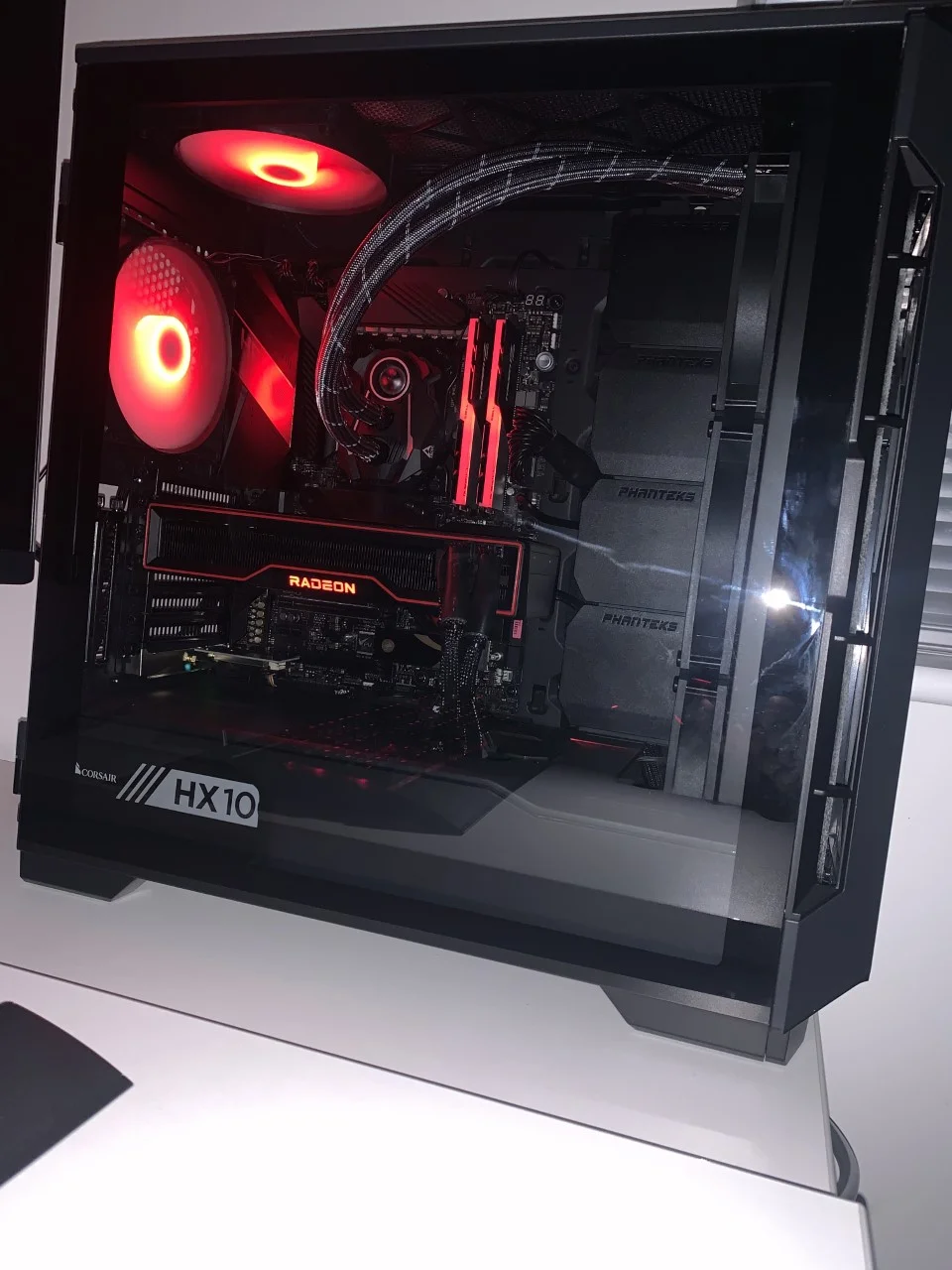

I probably would have been fine for 95% of games. The 6800 wouldn't quite have cut it in Cyberpunk for me at 3440x1440 though without having to dial down some settings to hit 60 FPS. I would have got a 6800 XT if I could have got one at the time for under a grand. The nice unexpected bonus for me with the 6900 is having enough muscle to play games like Borderlands 3, RDR2 and Shadow of the Tomb Raider over 60 FPS at ultrawide 4K! No regrets here. :)
Ooo that's lovely and neat. What case is that Matt? I have the Phanteks Entho lux but the the side panel isn't a full window which is bothering me now as the pillar blocks the view. Think the next cash I drop on the PC will be on a new case.
It’s a Phanteks P600S, very nice case to build in tbh.
