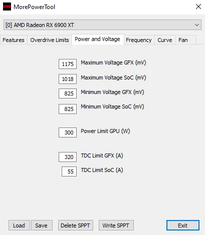

That said, I personally use 300W Power Limit GPU (W) seen in the screenshot below for my 24/7 MPT settings. I leave power limit at 0% in Radeon Software as i like a 300W ceiling for board power. This is plenty for games IMO and you can run silent fan profiles and keep the Junction temperature below 110C - throttling temp - assuming you have good case airflow, plenty of intake (2-3 fans) and 1+1 exhaust top and rear fan.
I undervolt the MAX SOC voltage to 1.017v (1.000v ish actual under load) which saves a few watts of power and heat.
MPT
1. Download MPT and GPU-Z.
2. Run GPU-Z and save the BIOS somewhere safe on your PC.
3. Launch MPT, click Load, load the BIOS you just saved.
4. Select the drop down box and your 6900 XT.
5. Click Power and Voltage tab.
6. Change only the following, Max soc voltage, Power Limit W, and or TDC (don't really need to touch TDC unless going for silly high power draw).
7. Once you've made your desired changes, click Write SPPT.
8. Reboot.
9. Your settings are applied on next boot.
10 Click Delete SPPT in MPT to restore default values.
On the 6900 XT you'll get best results by lowering voltage from 1.175v, but this can be done in Radeon Software > GPU Tuning.
