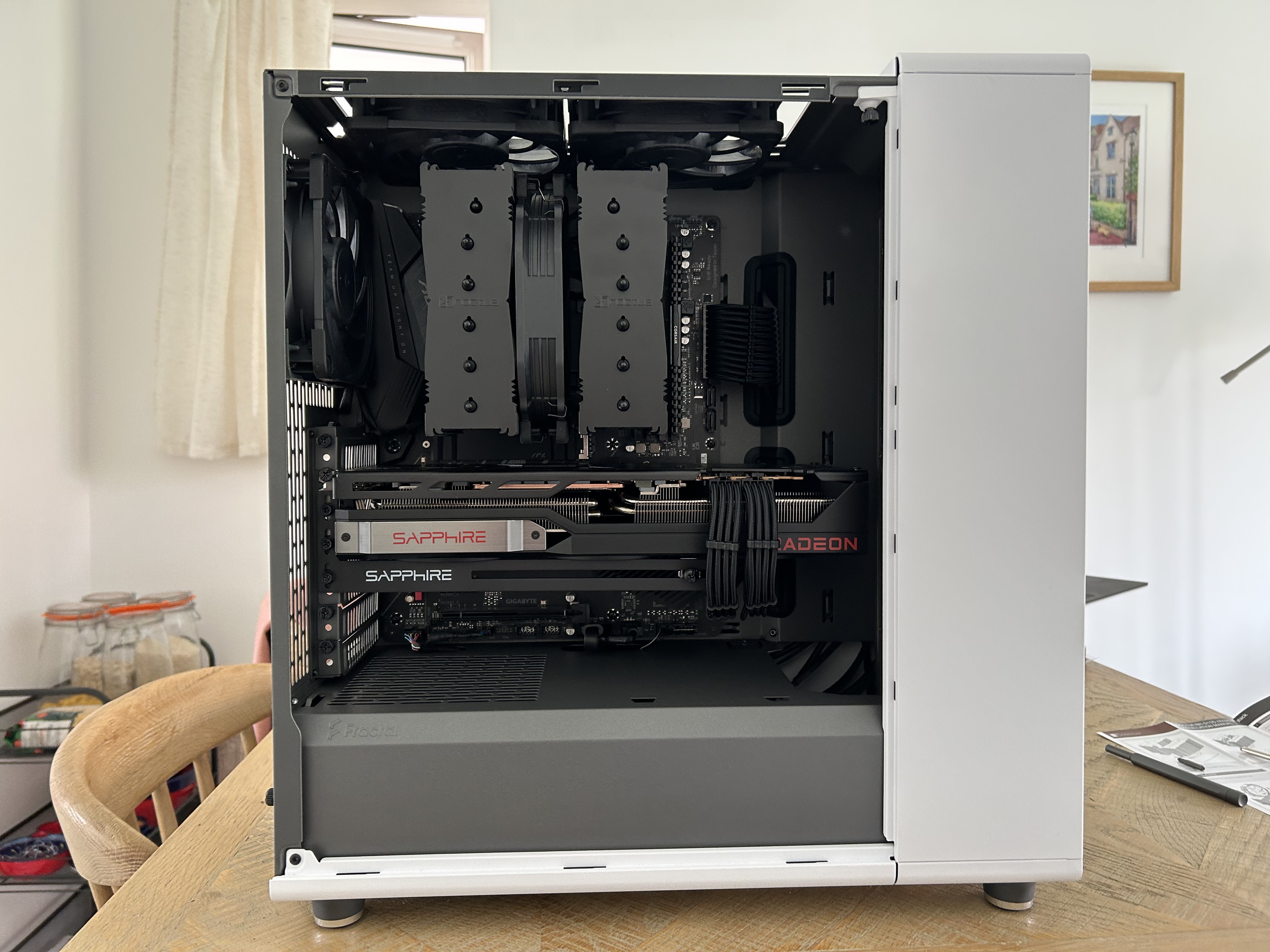

So the 7900XT is a lot bigger than I thought it was - no issue fitting it in the case but definitely happy with my decision to change case at the same time.
Also swapped back to air cooling with the D15s (replacing the EK Basic 240mm AIO) and already much preferring the noise levels and lack of pump noise. Only managed to run a few benchmarks / stability tests but so far the 7900XT is suspiciously cool, running it at 100% with Heaven 4.0 and I can't get it to go above 67 deg... Performance wise seems brilliant too, will give it a proper whirl later today!

Thats a really tidy build. Great job!
