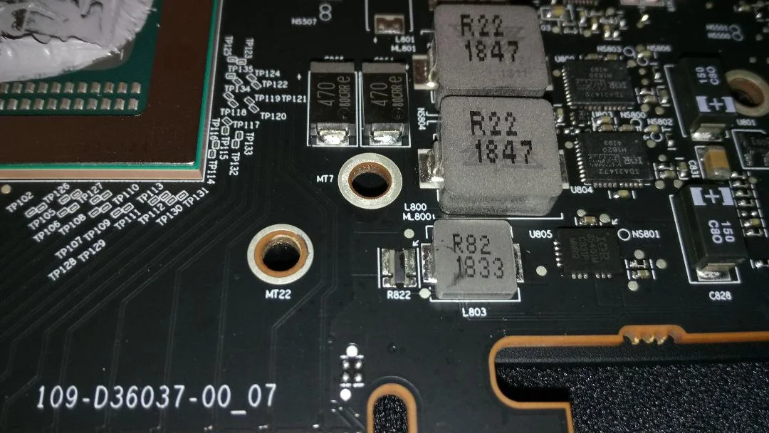

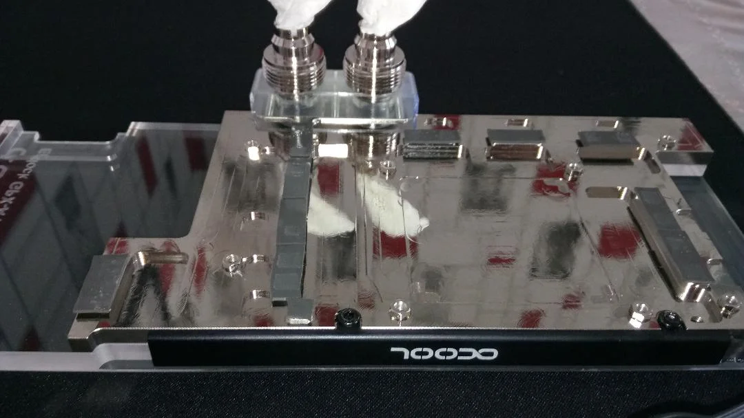

I've done some investigation this afternoon. The reference cooler doesn't have a pad over "R47 1833" but the alphacool pads are 1mm thick. The reference pads are thicker and the EKWB block doesn't use a pad either.
This is my block removed and as you can see the pad hasn't even been crushed like the rest with the imprints of the vrm. Mines a Sapphire card.
Just to give a easy measure of 2mm, a 2p coin is 2mm thick so the "r47 1833" should be just slightly less.

The one that is at issue doesn't have a pad over it in your picture. It would sit in the area of the black rivet on the lower right-hand side of your picture.
I checked my bykski block when fitting it and had contact on every pad, my card was a gigabyte card from launch, so I would imagine a reference card. any manufacturer selling the VII should state reference design or non reference design clearly.
by the above picture it looks like you have no contact on that pad at all, so your component is shallower than the block, if alphacool is saying it could damage that component by crushing it then it seems some touch the pad, which alphacool doesn't.
and some do which bykski did on mine. EK we have no idea yet. but what worries me is the fact the reference air cooler? is this subject to the same issue of components being different heights offering poor contact on some cards causing higher temps.
I cant see all manufacturers making the own reference style cooler to fit there card alone, I thought they just stuck the stickers on the fans only. A little concerning for people even with the standard air cooler. a lower component you can use a thicker pad, but higher and crushing it or holding off the heat plate from GPU is not good.

sits in recess in block marked in green. doesn't look like a thermal pad even sits on it, just a cut away in block.
You're right, getting the picture mixed up lol. I think its going to be referring to the black screw that holds the RGB strip in place that will crush the component if its too tall!
I'VE JUST GOT MINE OUT AND IT IS THE BLACK SCREW HEAD TOUCHING "r47 1833"!!!
AND ITS DAMAGED IT!!!!
The black screw head isn't sitting inline with the r47 1833, looking at the pic on the page before it sits directly beneath the coils with thermal pads on, unless on your card r47 is not in the same place as Pic.
this pic

isn't R47 in the same place on your pic and the pic supplied? does R47 sit in a cut out directly below the thermal pads, is the cut out not big enough and clamps on the edge of R47? I can see the mark on R82 as well. was not well thought out the alphacool block.
No its crap in a word. They aren't sat in a cut out. If the screw heads where flat it wouldn't of been an issue. Its a deadly RGB strip!
yea I see what you mean now, been a long day mate, and yes it is crap as alphacool should have used flat head screws. hope your card is ok.
