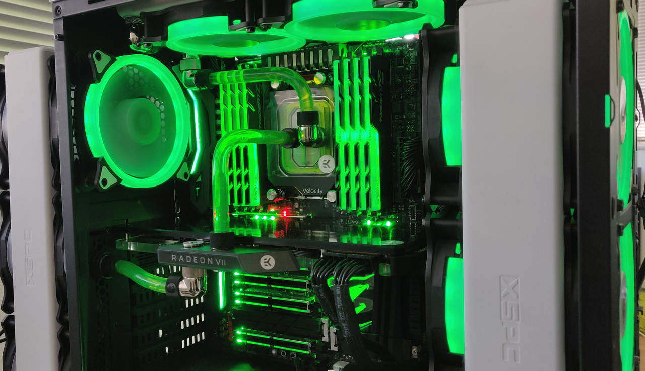

A little cable management and tidying up left to do but pretty much there!
Welcome and on TROH.:)
The Roll of Honour.
