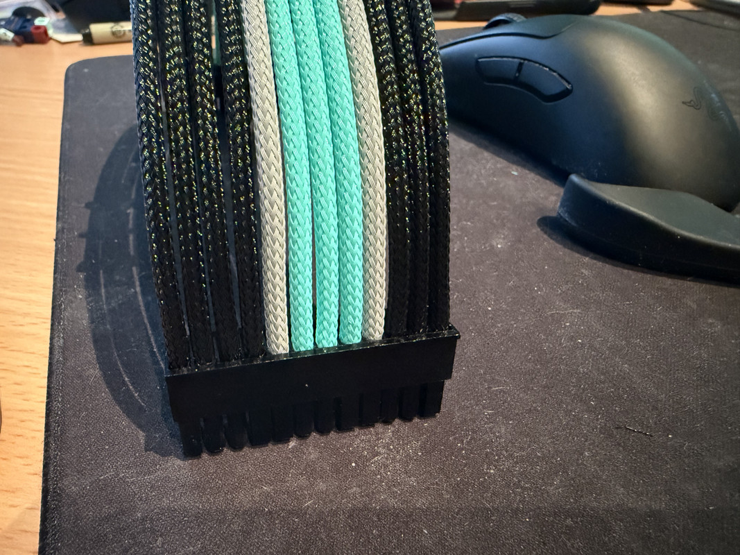

I will never not do it myself ;) my cable runs always have a quirk to them after working out the routing which creates sizable variation in wire lengths in a single cable. Plus I prefer paracord to PET and seemingly the few cable makers who do offer paracord don't do it properly (550 is too big, people! No wonder you complain it looks like shoelaces).
But still, always gotta appreciate a super tidy heatshrinkless sleeve job, lovely stuff.

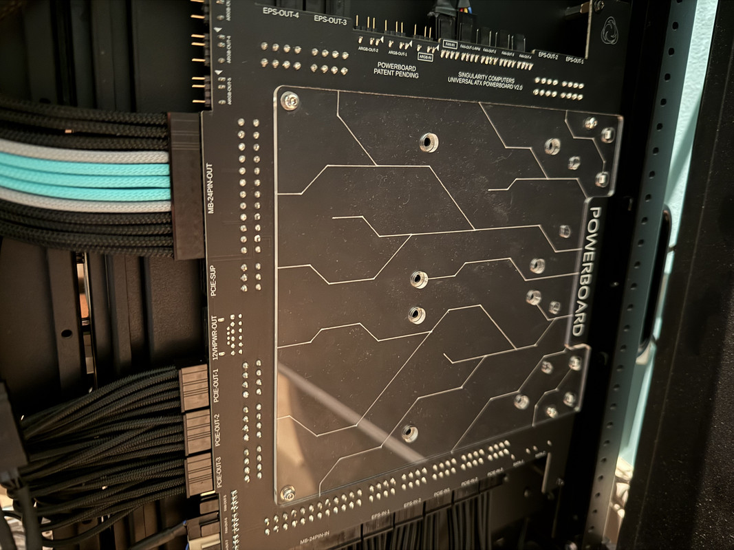

Honestly; this is one of the massive advantages of the powerboard; it makes the cable runs really simple and predictable from the powerboard to the motherboard.
I realised I'd used some old sleeving to do the black; which wasn't quite a thick as the new one. So I redid those 2 wires and finished off the outside of the curve.

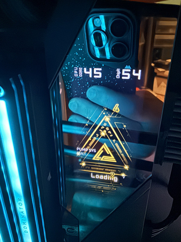

I so wish i could do my own cables. Eyeballs are good enough for it but is sure so eadmire your cabling skills sir. I see you also got teh screen working again, did you flash firmware and data?

For me my dynamic daqshboard stopped working first making the usb cinnecting disconnecting sound day later the entire board stopped working. I seem to be an outlier with regards to whole board not working. Mine has gone back
Ok, so. The dynamic dashboard is part of a removeable section of the motherboard; the EZ-Bridge.
This has a few headers on it and a proprietary connection to the motherboard. Unfortunately one of these is the front panel IO connections.
Once the board goes dead, nothing connected to it works (hence the USB connection / disconnection) and also the power switch (joys).
Generally this is pretty reliably around every 5-7 days. I have fortunately been able to re-flash the EZ-Bridge with the firmware tool MSI provided which brings it back to life for another 5-7 days, but if there isn't a permanent fix for this soon. It will be going back under RMA.
So I am still able to boot using the power recovery settings or wake on LAN, both of which I have enabled in the BIOS, obviously this is super annoying when I have to revert to this!
I haven't seen anyone where the full board was unusable (other than that they were unable to power it on).
