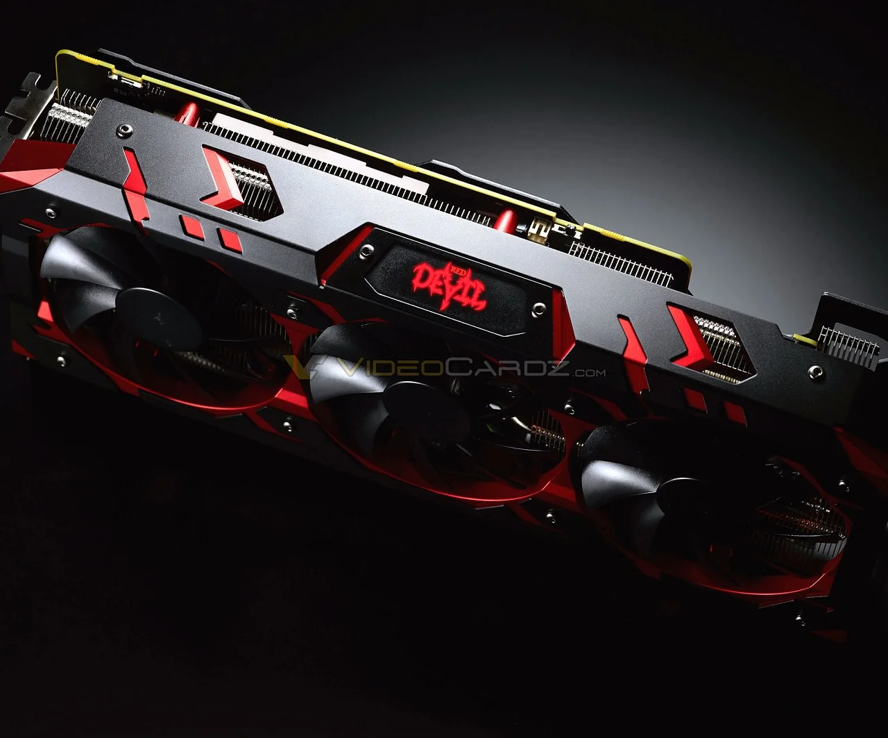

To be honest I just want a Vega with non reference cooler that operates quieter. I dont care about extra performance. And no i dont want to undervolt or whatever i want an out of the box solution.
Not being rude, but doing a little testing to find the sweetspot is the best way to deal with all the Vega lineup. It's not really a turnkey solution, it's a bit of a tweakers solution. For my clients if they don't want to do a little testing to find the sweet spot, then I'd honestly not recommend a Vega. IMO the silicon can't bend to my will, but I can adapt to the silicon I have.
No worries. Ill wait and see what happens around and after Christmas with what's available at what price and then decide.
