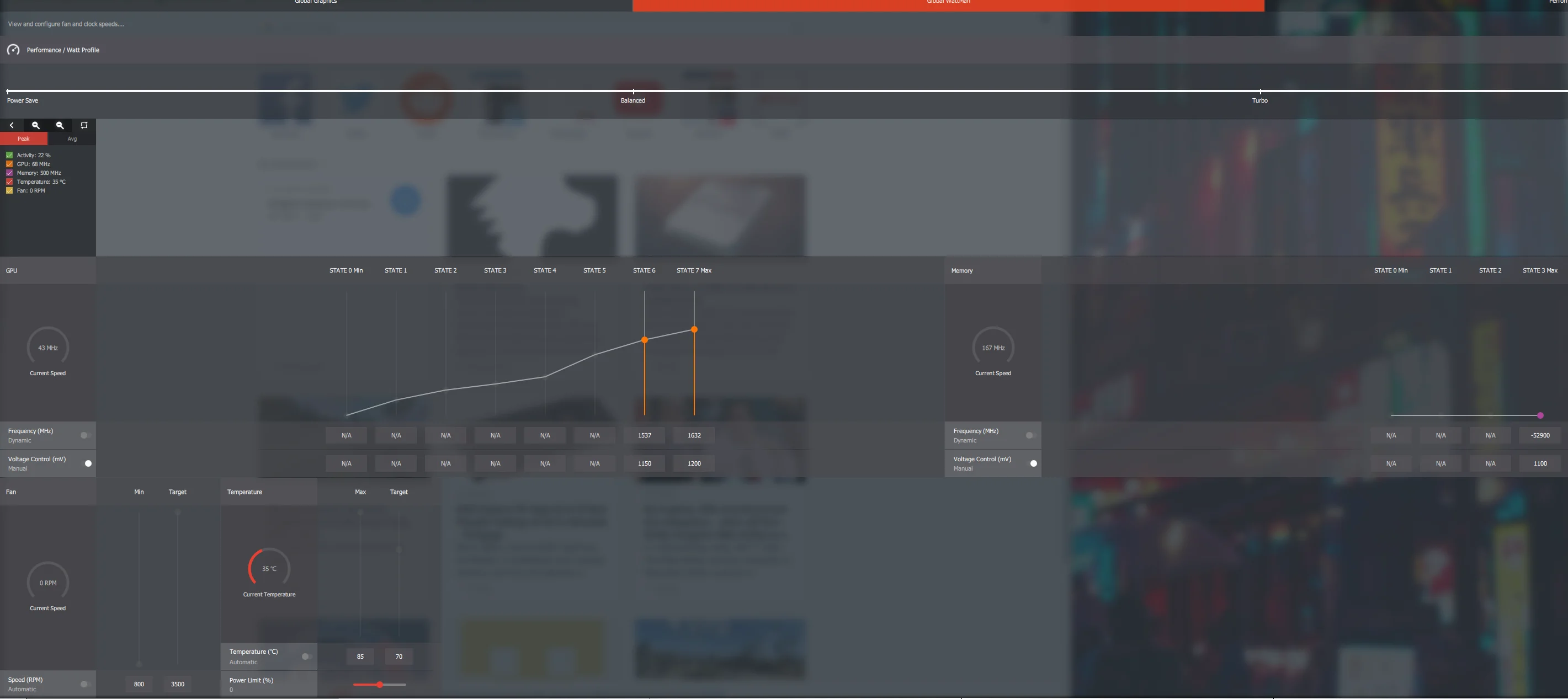

I used some custom settings you suggestedin an earlier post which did increase the benchmark a couple of fps (57 instead of 54). I was using Riva during the test and the card was moving from approx 1380 - 1520 during the benchmark. The Fans went sa you said from 70 - 89 and back as the clocks changed. Average heat was 63c during the test.
What I'll do tonight after work is install the bits and bobs you've mentioned above and give you more accurate info :)
For reference, my wattman settings are currently this:

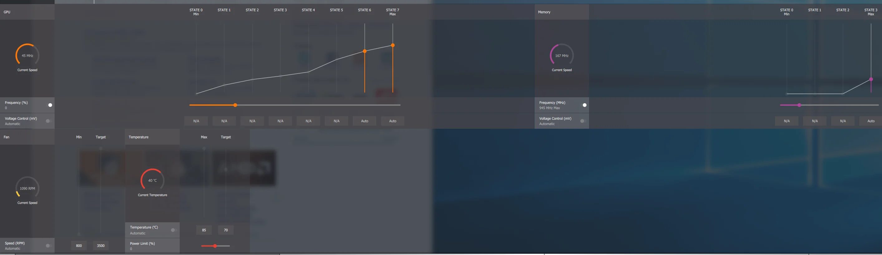

You changed your post mate :p
Also you have downlocked the HBM to 147mhz. Thats crazy completely culling all your performance.

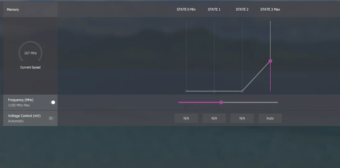

Have I? I think it's on dynamic, I only touched the power. At the time I had nothing running so it isn't running fast :) But gaming that bad boy goes to 985 -990. The weird this is that if you look at the frequency above the voltage the in the right most state - it's in the negatives - which is weird.

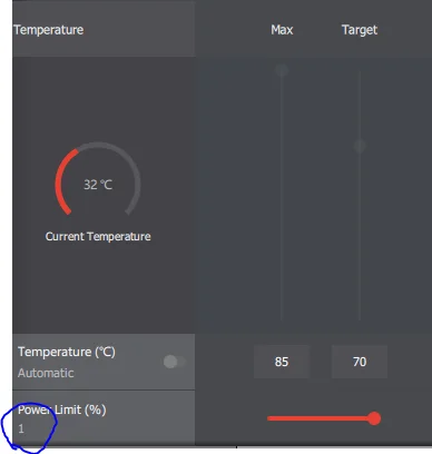

Also - when looking last night, that power slider would only go to 1, is there anything I need to change?

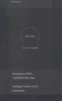

On the images you posted yet. It has a typed number of -5xxxxxxxx.
Click the reset on the top left corner :p
If you go custom overclock look at my previous post. Most of the gains with Vega are with HBM overclock than core, and 1100 is your max target, 1000 your minimum.
But use the horizontal slider bar to set the "gaming mode" (State 3 max) HBM speed. Like this. Around this area don't touch anything else :)
Also the reason asked you for HWInfo HBM voltage is because if your board pushes 1.35-1.356v (these are the max HBM can take before degrading) then you are OK.
However there are boards like the reference which push less HBM voltage. These need to be flashed to achieve 1100.

I've reset Wattman settings and I still have that weird number:
Again, I can;t push power past "1"
Think I'll DDU and re-install catalyst to see if it's a borked install.
Edit: If It set State 3 to min, the HBM clocks at 945. The voltage going in according to HWinfo is 1.356

Use DDU in Safe Mode. Wipe everything and use the 18.8.1.
Let us know how it goes.
