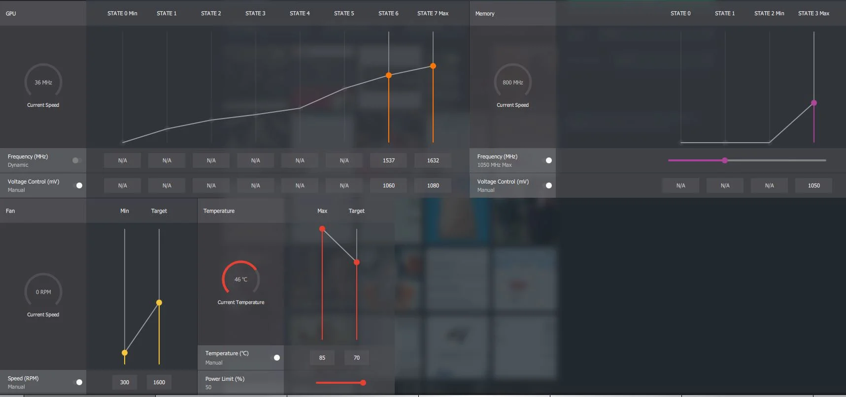

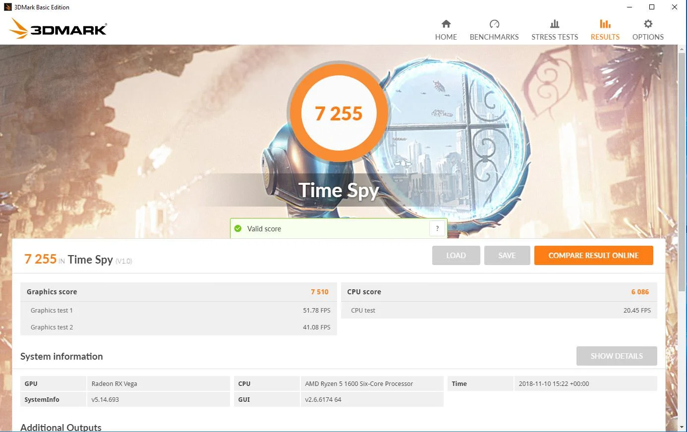

done a couple of runs of 3DMark (free version) using various settings that I found from trolling through this thread.....no idea if the result is good or bad - anyone comment on the below? one thing I noted was the power draw at the plug (connected to a power meter) topped out at a max of ~430W, I was expecting that to be much higher?
best score
using these settings

Cut some power to the card. Reduce by 50mv the P6 & P7 states and add +50%PL
It will improve the perf and cut power & heat.
Shall you wish OC the HBM to 1000-1050
yea, already got the hbm oc'd.....think I've done it correctly!
Tbh timespy is not the best graphic benchmark as the Graphic test 2, doesn't use proper DX12 but some special Nvidia optimizations, which cripple AMD performance.
Use Firestrike as is more relevant to show the graphic performance.
do you have to pay for that though? (i'm a miserable sod and don't like paying for bench mark software!)
