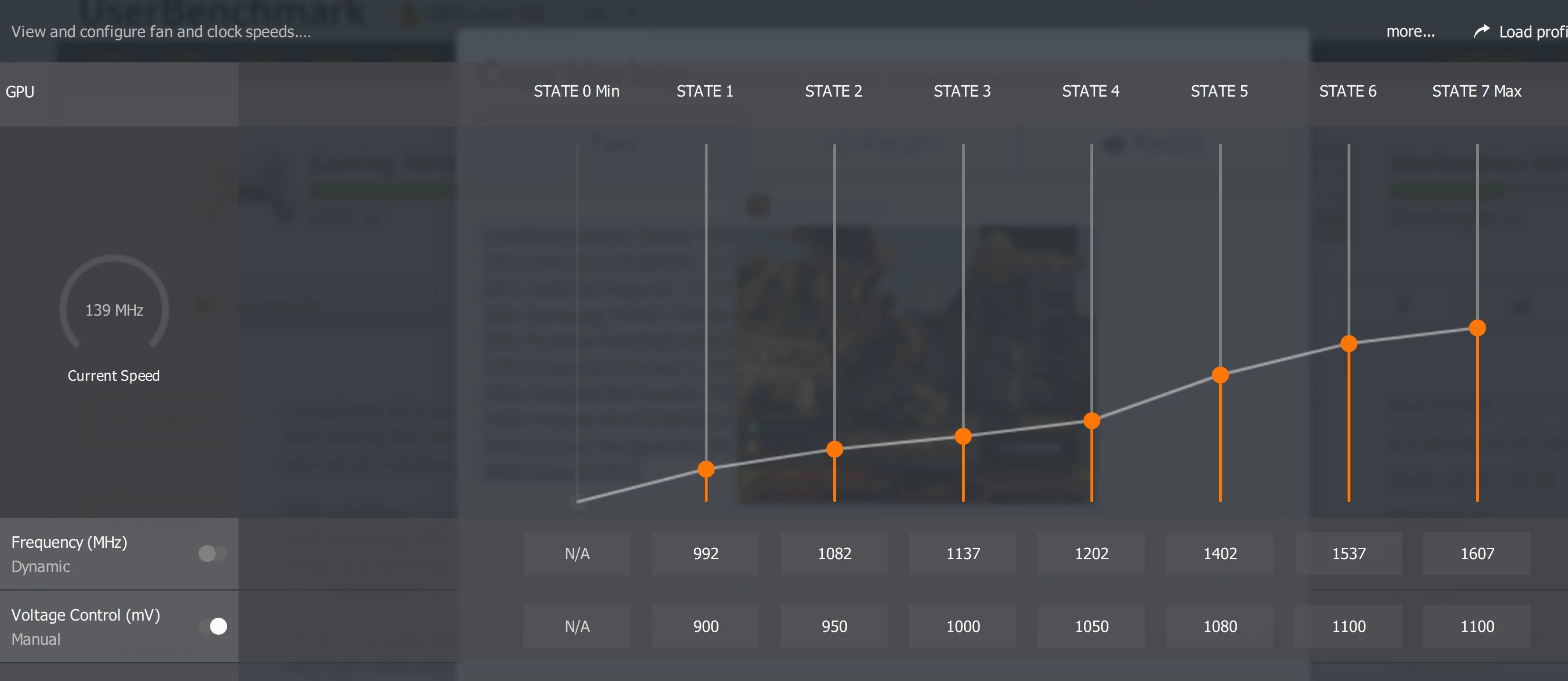

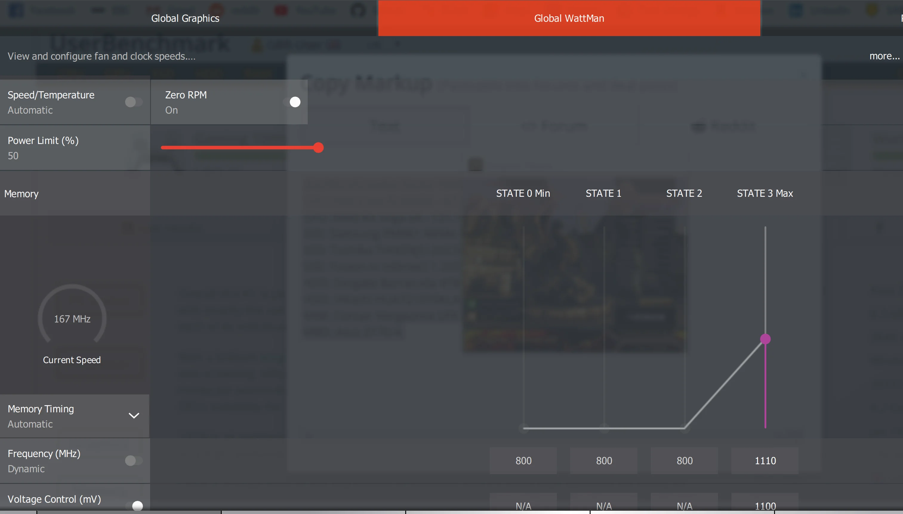

@ " Vanilla" Ok heres a suggestion, up the memory to 1100 and set the voltage to 1100mv, that'll give you identical settings to me. Then run heaven benchmark using the settings outlined in "Kaapstad's" heaven benchmark thread in this forum. I'll do the same and we can compare scores.
Ah are mine not already at those levels? I'm confused?
Or you mean my settings are good and to run heaven?
Sorry, my bad, you've already set your memory to 1110mhz @ 1100mv so these are now identical settings to mine. Now run heaven using Kaapstad's settings for heaven and see what you get. Run it "windowed" so you can see what speeds/temps are in gpu-z 2.16.0

Ok, I'd say your virtually bang on performance wise and your score is slightly higher than mine, probably the 6600K playing a part here. NOW, up the P6 & P7 voltages to 1150mv, raise the P7 frequency 1697mhz, nothing else and re-run heaven. When finished, check your gpu speed in gpu-z, it should read about 1630mhz ish (thats the max boost clock quoted in the specs). Check your power draw too, it'll probs be around 280w.

I think I did the right settings but again seems to have no effect. Maybe CPU is holding me back?

HBM is too high and results to lower core clocks. 1100Mhz HBM is ok.
Also change the Voltage under the HBM to 1000
Core. Set 1632Mhz the P7 state and lower the power of P6 to 1090
