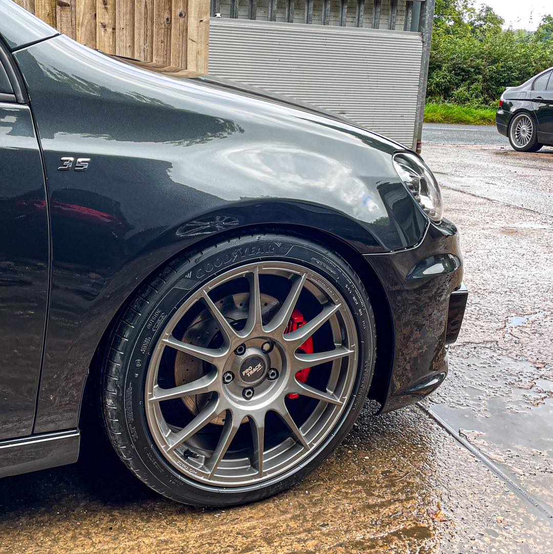

Went down from 19s 8.5j to 18s 8j and man the front end feels good. Plenty of grip with the GY ASM6 + far better steering feel than the PS4S.
Is that an Alpina? Some pictures of that please!
