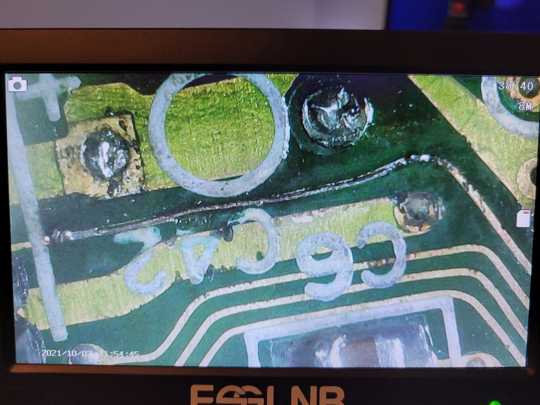

Take a look at that trace near c42 marking...
Scraped a bit and the trace in that area is non existent. This is it cleaned up and tinned up ready for a jumper
Trace repair done...

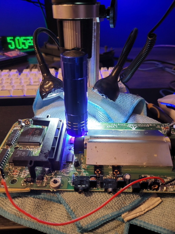

Not being sloppy on this one so masked the area:

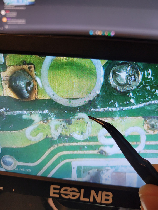

Scraped back some other areas.. and tested all the rotten vias
More nasty traces:

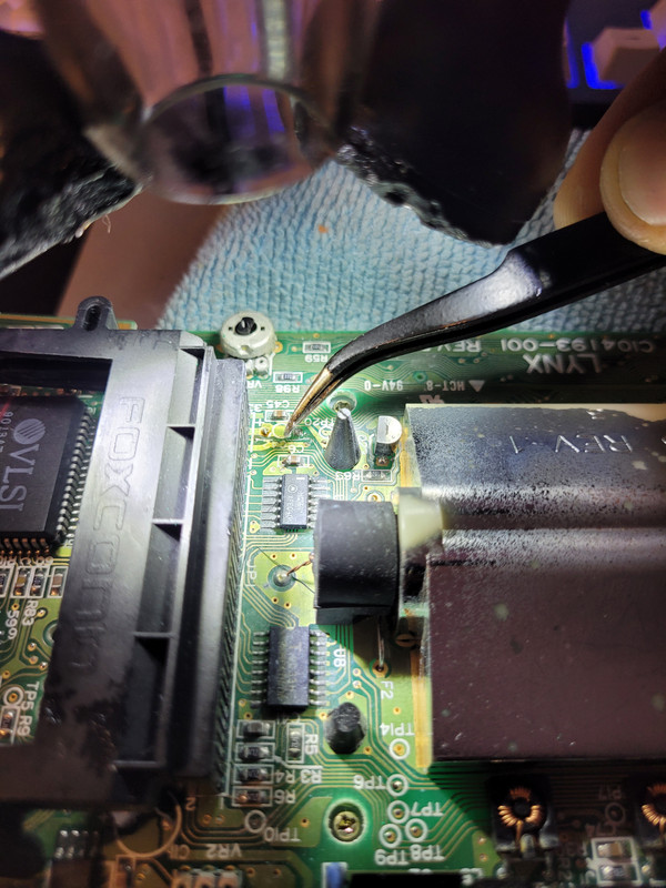

Test point 10.... What test point 10?

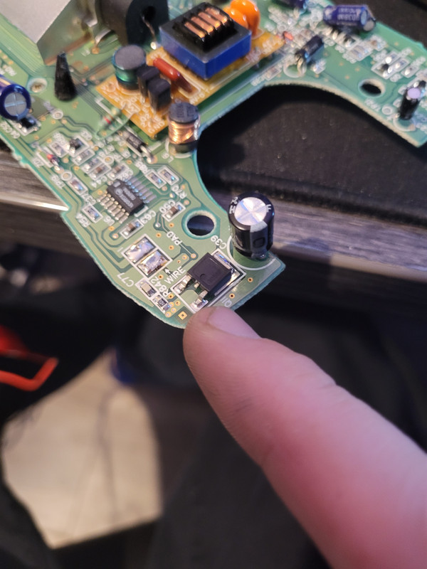

But this area started getting hot... So I swapped out that cap (ive not recapped it, the caps on there are clearly somebody else's attempt to fix this one) but the area is still getting hot, when I mean hot I mean burn you if you touch it hot!
This little fella is our culprit, its a mosfet, I did some digging and it looks like you can swap it out with an On Semi MTP3055E which is seemingly a direct modern replacement. Given I havent spent a penny other than some magnat wire and time getting it up and running £5 on a decent mosfet isn't the end of the world.
After a while this happened!! :D
