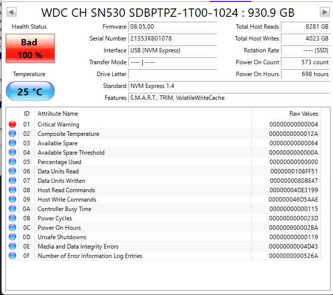

Congrats. Getting an ssd alive again is fortunate. Are you ble to clone it to a fresh drive?
Yes indeed it's now on a fresh physon drive I pulled from a series X that wasn't fixable. I managed to clone off around 30gb at the beginning of the drive doing a sector clone and then wrote that to the new drive, after that I rebuilt the system using osu1. Now its all updated new paste etc and tested playing some gears 5... it's a happy xbox now.
