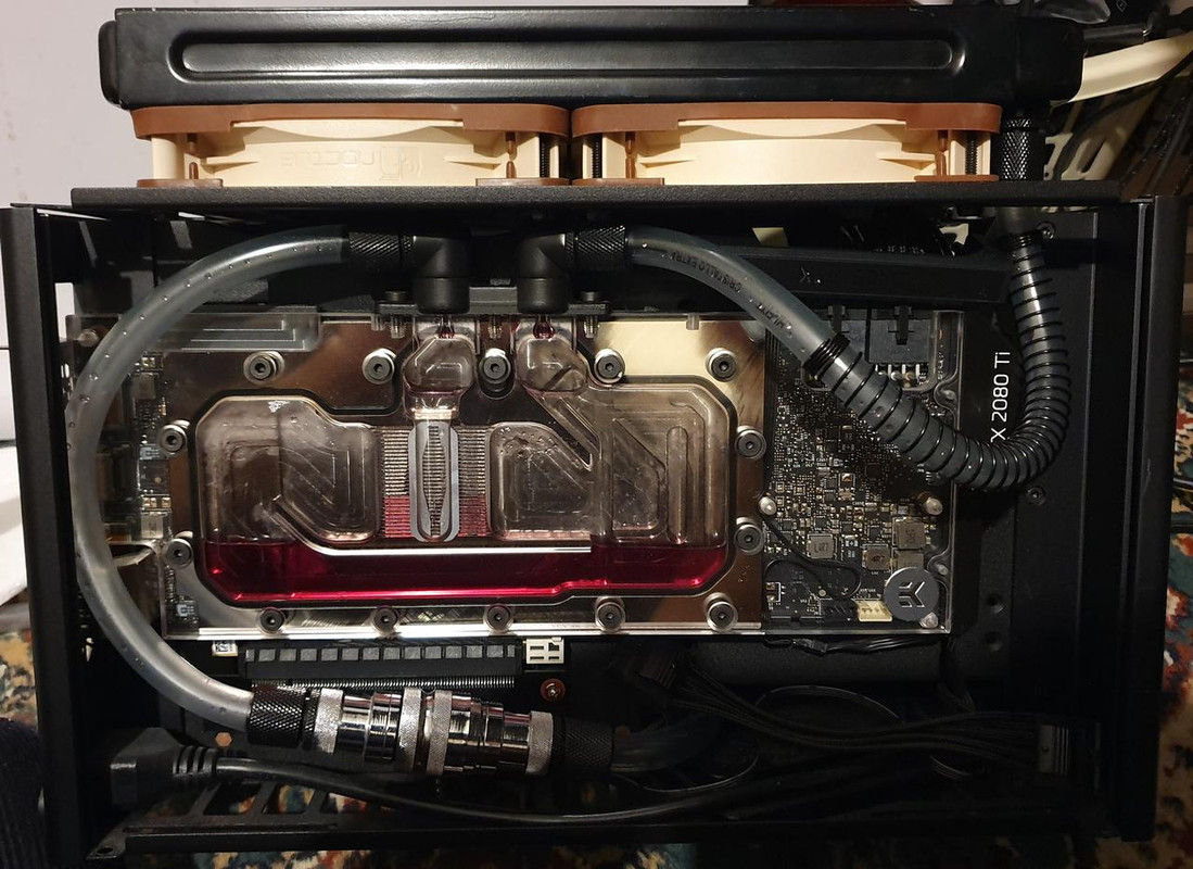

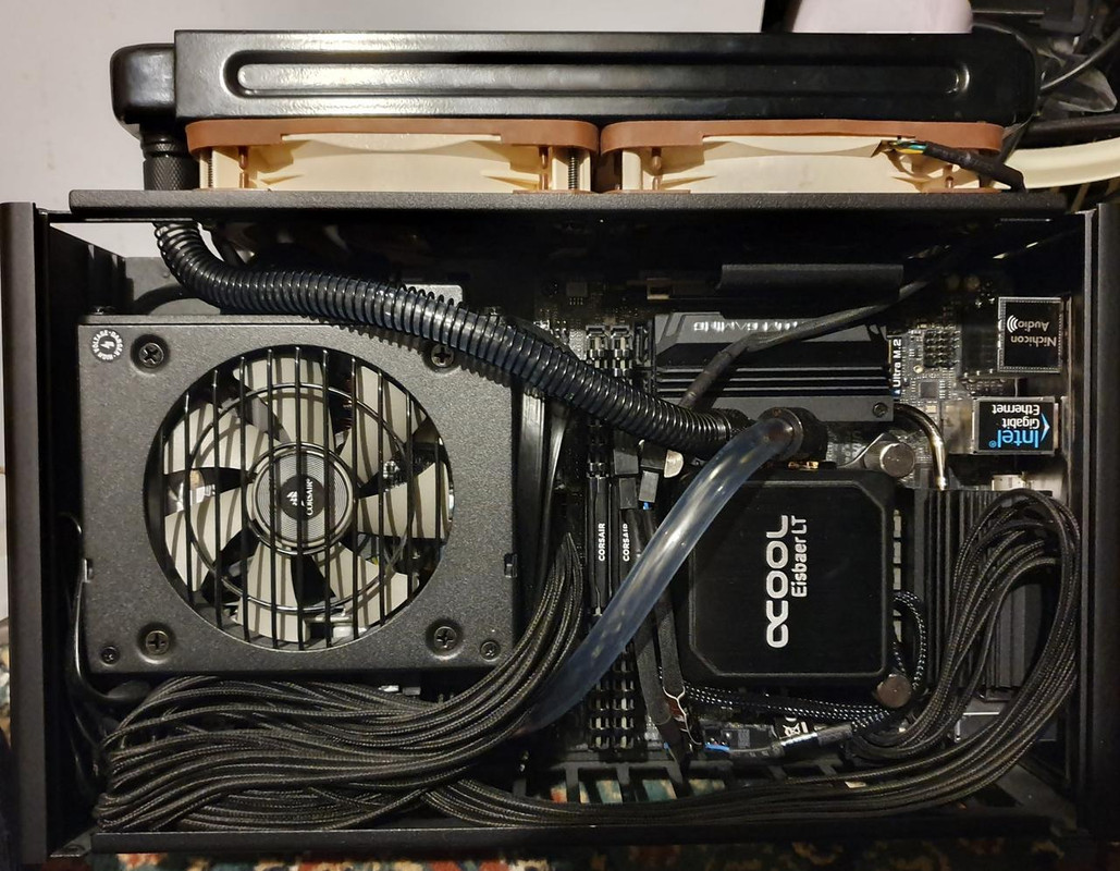

Downsized further from a H200i. Louque Ghost S1 with a 9900k & 2080 Ti. Really wish they would make stronger pumps, it's a shame the apogee drive is so difficult to source.
