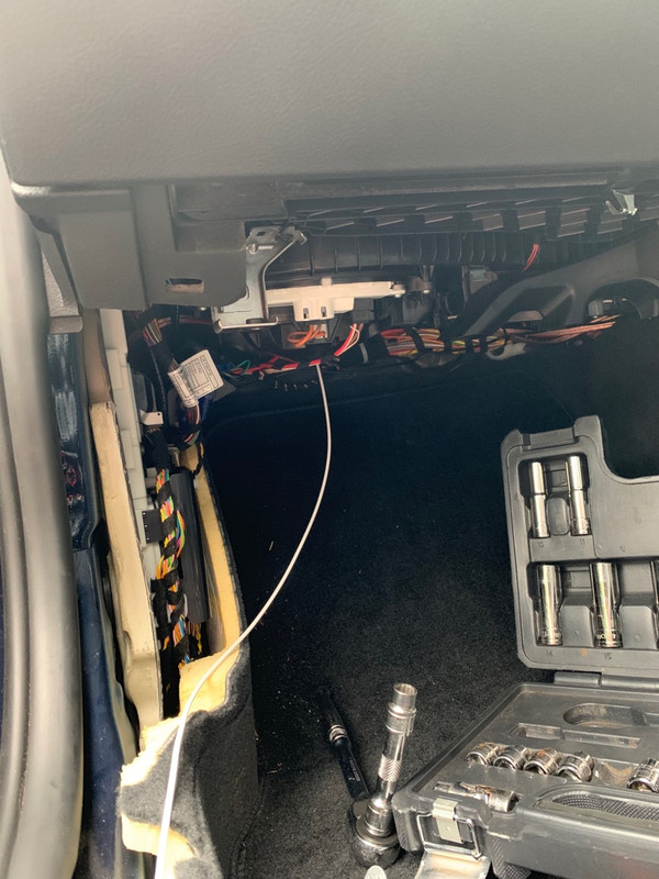

My car originally had a cloth interior without heated seats and last weekend I fitted some heated leather seats in which are all good, except the car doesn't have the wiring for heated seats and of course the buttons aren't there either. I'm not overly bothered about having heated seats but my previous car had it and it is a mild irritation knowing that the heating elements are there but just not connected. So today I have fitted a new climate panel with the heated seat buttons and made a start on running the wiring:
They won't do anything yet but at least the buttons are there. Will VO code the car to enable it when I've done the wiring.
Annoyingly the two fuse boxes for this car are in the engine bay and in the boot. The fuses for these cars with factory heated seats are in the engine bay fuse box so that's where my power wires will be running to. Luckily BMW made it really easy to get wires from the engine bay fuse box into the car itself:
Managed to run ground wires to each seat, the power wires from the fuse box to each seat and the power wires for seat back adjustment to each seat before it started raining again. Just need to wait for the order of the terminals and connectors to arrive from BMW, crimp them on and run one last cable from each seat to the REM module in the boot and VO code the car then it should be good.

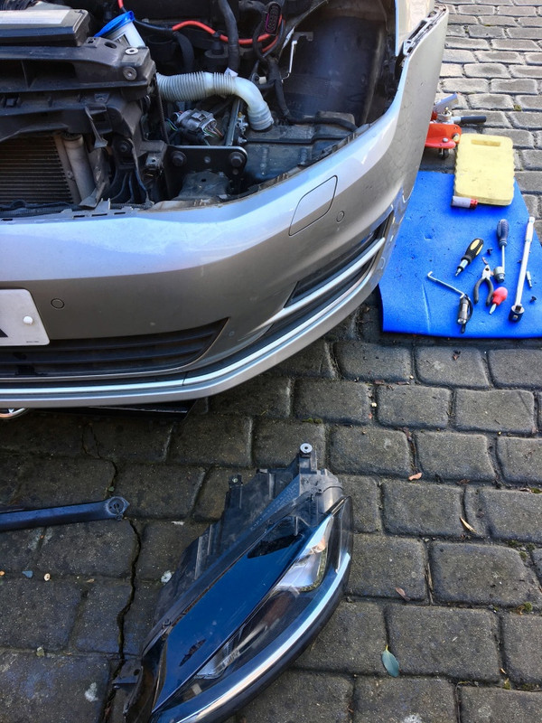

One bulb was on its way out so swapped it out on both sides.
They don't half make it difficult to carry out on a modern car do they? Front grille off, jack one side up and turn wheel each way to get to the screws holding the mud guards in place, pull away part of the bumper to get to a screw on the side of the light cluster then unbolt varies ones holding it in place then finally you can slide the whole unit out. Open the back up and swap the bulb out. Put back together then the same on the other side. Complete ball ache but its done now at least. I thought xenons were meant to last more than 5 years?
@Duke tell me about it! Had to rip half my engine bay apart to get the xenon bulb on my Lexus. Replacing indicators requires taking the front bumper off. It's a joke.
Wow, that's bad design. I still remember when Ford made it nigh on impossible to change a bulb in a Mondeo. Needed to remove the coolant reservoir and everything!
