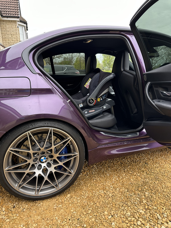

Put the baby seat in it ready for the nursery run in the morning.
Yes I know the car needs cleaning, job for another weekend.
