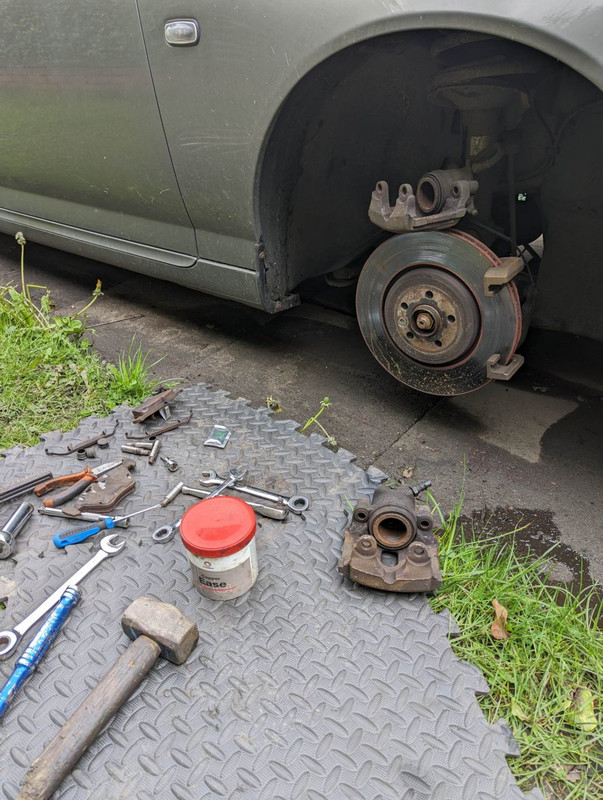

A couple of years ago I upgraded the brakes on my MG ZT from the standard 284mm discs to the bigger 326mm discs from the ZT190 (same caliper as the E46 330). The calipers came with lightly used discs and pads so I fitted them at the time and had absolutely no issues with them. A very worthwhile upgrade!
I noticed that the front pads were getting low so late last year I changed them. Initially everything was fine but driving home one cold January evening I started to get a really nasty wheel wobble and plumes of smoke from the passenger side front wheel... great! Luckily I had a set of spare calipers that I'd intended to sell but hadn't got around to it, so a couple of days later I braved the wind and rain and changed the passenger side caliper and once again everything was fine. I figured maybe there was some corrosion on the piston, I ordered a rebuild kit but kept it to one side rather than immediately rebuilding the old caliper.
Fast forward a few months and a couple of days ago I noticed another wheel wobble and smoke, this time from the drivers side.... WTF! I've had issues with rear calipers sticking before, but never normally a front. Out came the other spare caliper and yesterday I swapped it out... I didn't know BMW calipers were servicable items! Thankfully the weather was a bit nicer this time and the whole job took about 40 minutes.

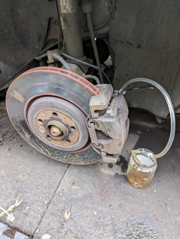

I swear by this 1 man bleeding method. No messing about with pressure caps or vacuum bleeders, I've never owned a car where the pressure cap will fit so don't even bother with them now. Instead, just add enough brake fluid to submerge the hose in a jar, crack the bleed nipple and pump the pedal.
The disc has clearly been running stupidly hot and now has a little bit of visible scoring, so that's a job for another day. At the same time I'll paint the calipers and if the brake unions play nicely, fit the braided lines I've had lying around for a while.
I've also got another rebuild kit on the way and will rebuild both of the old calipers ASAP... just in case...
