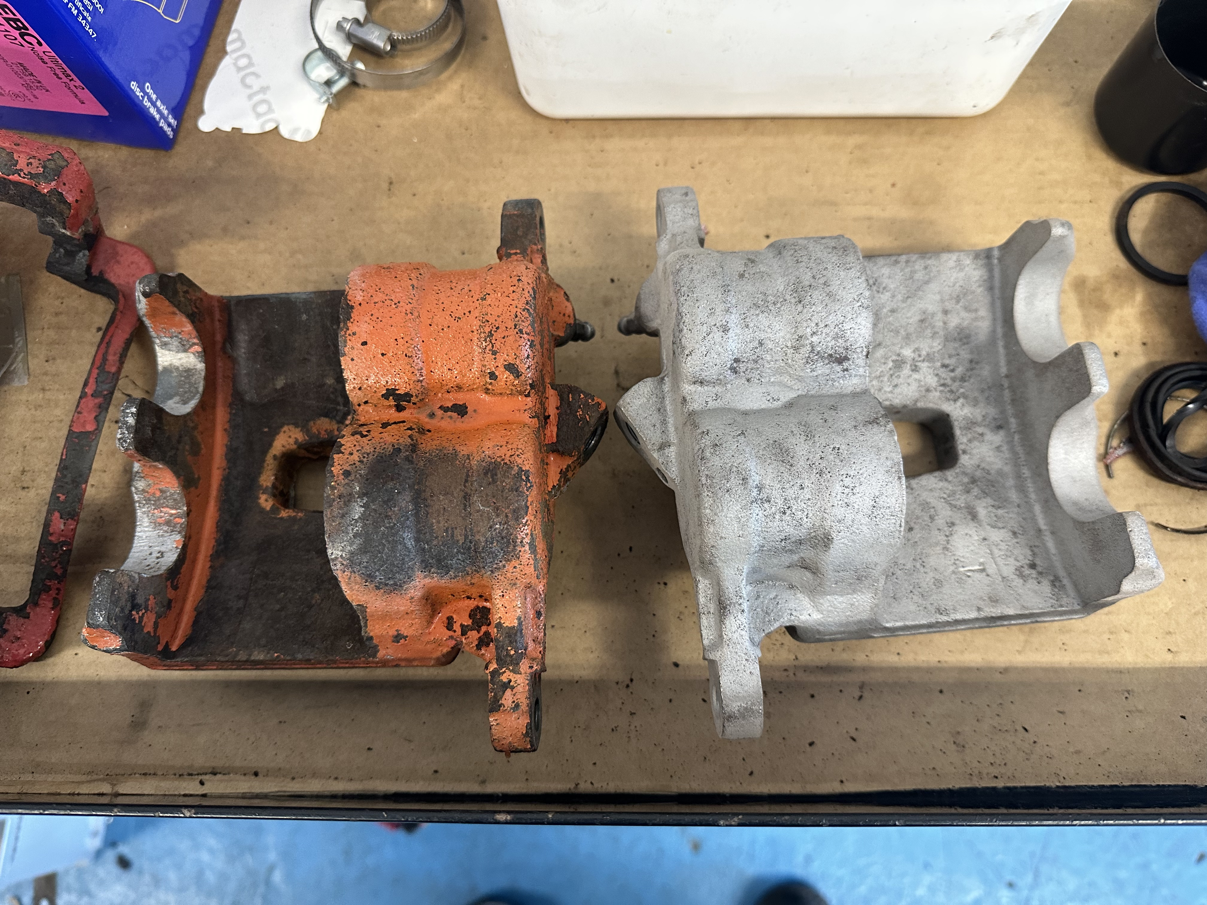

Haven't updated progress on the MR2 for some time. I'm currently working on getting the brakes sorted. After 8 years off the road, seized calipers weren't too surprising. So I've got one side done so far, shot blasted, etch primer, painted and a rebuild kit with all new seals etc. Caliper pistons I chucked in the lathe and polished them up, they came up really nicely. Discs have been skimmed on the lathe to remove surface rust and some pitting from where the pads had sat in one position for a very long time.
Before
After shot blasting
