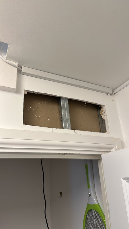

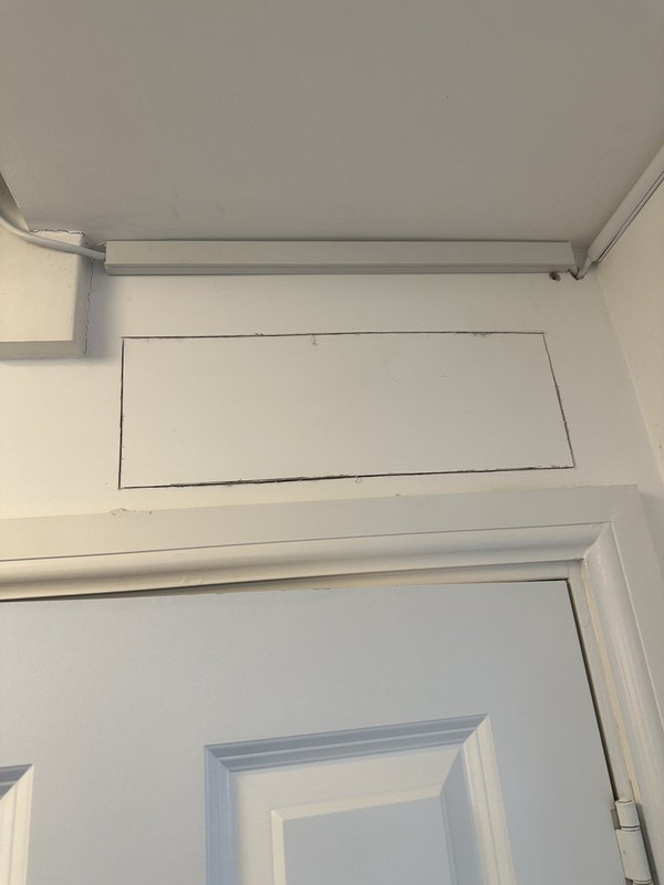

All my IT kit is in a little cupboard under the stairs (1 firewall, 2 switches, 1 NAS, two Xeon servers, one Plex PC etc) and I've had to keep the door ajar for ventilation which annoys the mrs as it's in the hallway of the house. Bought a vent thing and fitted it today, it should hopefully mean I can have the door closed. Ignore dodgy drill holes and trunking, it's on the list to do.
Cutting stuff.
Done away with the plasterboard fitting thing using snips. Ignore black cable, I need to terminate a new one.
In and working, it's American hence it's showing in Fahrenheit. Door open and it was 65 degrees, door closed for a short while with everything on and the fan on low and it's showing 77. That'll do nicely.
