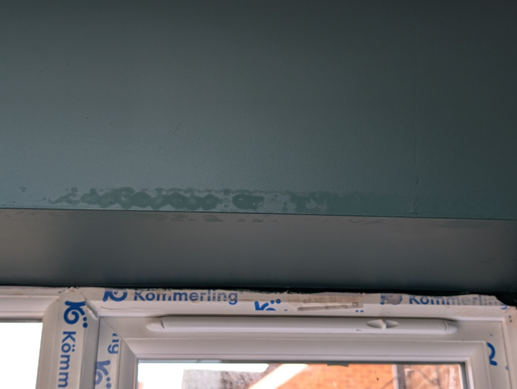

I painted the new extension, but this happened over the plaster where the metal edging is. Anyone know what can be done?
Almost looks like the plaster in that part is still wet - have you tried a hairdryer at one end of it for a bit to see if that helps?
Edit - seeing the shocked emoji, I probably should clarify that I didn’t mean blasting it with said hairdryer on max heat :D
It's been almost a week since it was painted. It's also been several weeks since the plaster went on. I'll try some gentle heat to see if I can get a reaction though
Oh that's weird. Is the plaster properly sealed i.e. mist coated? I'd have assumed paint would peel rather than staining like that though.
Oh that's weird. Is the plaster properly sealed i.e. most coated? I'd have assumed paint would peel rather than staining like that though.
Yeah it had a couple of coats in Zinsser on. It is weird isn't it.
I'm worried that the plaster is very thin, perhaps. Which would be quite the issue to fix.
Seeing the crack/line in the paster to the right and am wondering if it has been done correctly or not?
Not a plasterer btw.
