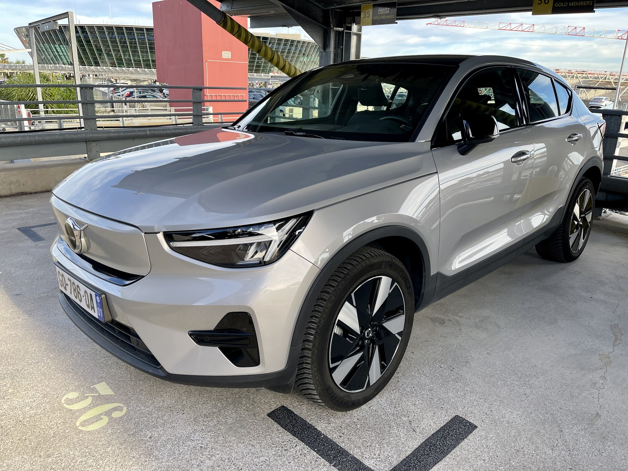

We booked a Peugeot 2008 or equivalent and I was convinced we are going to have a Hyundai Kona after seeming them specifically advertised elsewhere. I was quite pleased to end up with this instead:
A Volvo C40 recharge. First impressions were that it looked like a very smart solid car although who specifies diamond cut wheels on a hire car is a complete mug as they were already very scraped already. I briefly had concerns about getting everything in with the roof sloping down but there was no issue, the car was wide enough for the pushchair to go right across. Inside everyone seemed very solid and certainly a step up in terms of weight and feel than my similar sized petrol MG ZS crossover. The glass roof was a nice feature but sadly it does not open and I stil miss having a motorised boot on my own car now. Putting in a new and unknown car seat to a new car was a challenge but not a problem, just a shame that it was not in and ready for us.
One main fear was picking up a car with 100% charge and being told to bring it back with 100% again. When handed over it had 100% or 552km of range and fortunately told that bringing it back at anything over 80% would be fine. The first drive in a new car is always interesting particularly out of quite a narrow car park and someone else’s car to look after. The Volvo was quite like an automatic in that you put it in drive and it moves off itself needing to be held on the brake when stopping. I could instantly tell why electric cars are popular with the power being instant exactly as you want it to be. Out of the airport onto France’s concrete jungle of roads into the motorway we had our first encounter with the French driving like they are in the Taxi movies with a motorcycle passing us on the hard shoulder of a 270 degree curved autoroute slip road. The Volvo was fine on the auto route although my instinct was to want to change up a gear although there were none. The lane departure warning and assistance worked well as my instinct was to drive to far over to the right and it was good to get this out of my system before being on smaller roads. The trip to our accommodation in Mandelieu-la-Naupole via a supermarket took us down to 93% charge for about 33km

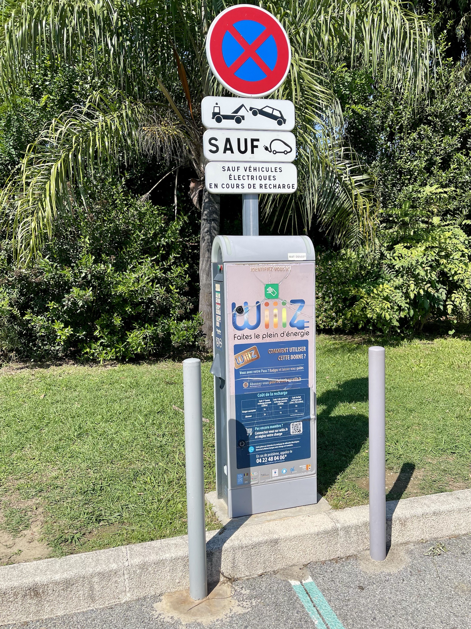

The local chargers from were from WiiiZ and I did not bother with signing up. My first attempt was a disaster firstly not realising they had little doors to open up rather than that being a plug socket the door getting stuck and slamming shut by accident and then confusing the machine and the operator about which side to the point we had to give up. The second attempt went smoothly.
Instructions for WiiiZ.fr charger
1. Plug your T2 cable into the car
2. Use website to find you location and charger and charger side note the from the front the right hand side was side 1 rather than the left as I expected.
3. Enter you are details and initialise the charge.
4. The side selected and button should flash, push the button to release the door. Don’t let the door slam shut on you!
5. Plug your cable in and close the door.
6. The unit light should go blue to confirm it is charging, on the Volvo it confirmed on the dashboard as well. If you keep the website open it tells you the time elapsed, amount transferred in KW and your charges so you can estimate when to return to the car.
To finish charging you just have to push the button on the door to stop and release the door so you can unplug.
