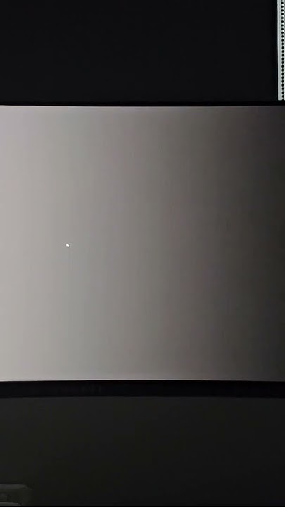

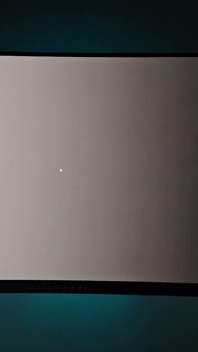

Why is it that there is less/no flickering in the scenarios where we had it before? I noticed that my firmware is 106, supposedly there are 2 different hardware revisions so different firmwares, maybe something here?
It may still be reduced in real life - this test is quite extreme but I have different monitor that does not flicker at all here.
If you have 106, can you try this?
When I look at my 2 videos, I THINK MOB205 actually flickers a bit less, but I maybe I am just convincing myself
I did try that the other day but missing some files and cba faffing about to get it running :p
So setting 144Hz does not raise near black at all(thats where you are wrong) - the near black level is the same st 175Hz and 144Hz - the lower perceived flicker is due to the fact that gamma shift from 144Hz to lets say 60Hz(or whatever the framerate dips to) is lower than from 175Hz to 60Hz.
If there is no near black gamma shift from 175 to 144, how does the perceived gamma shift from 144 to 60 become lower than 175 to 60? Surely it would be the same as in your explanation they are both starting from the same baseline? (you say 175 and 144 are exactly the same near black gamma)
There is a shift from 175Hz to 144Hz - its just so small that our eyes cannot perceive it. But the delta shift from 175 to 60 is higher than from 144 to 60, therefore perceived flicker is lesser on 144.
