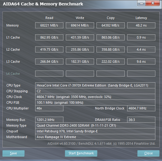

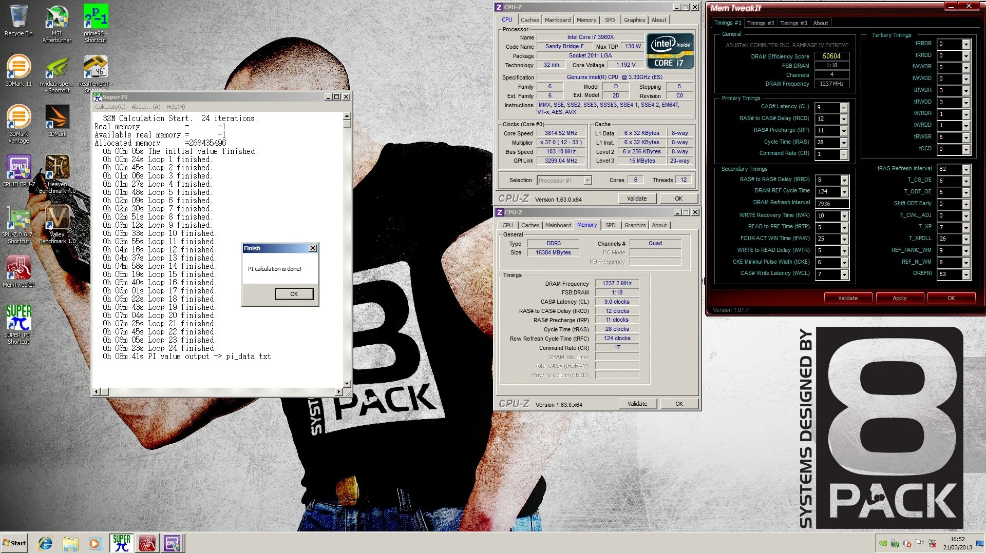

One other question, i found some 8 pack timings for scotty. His timings are looser than mine yet he has a higher efficiency than me. Why is that, is there some timings i should change? I notice he is using BCLK 103, could that be the reason for the difference? I'm using 100.1 BCLK.
yeah bclk affects ram multi/ram speed also,so tweak with a higher cpu pci/bclk if you can
memory efficiency means how well it is at performing
Wouldn't go mad tweaking the RAM unless your trying to hit a WR or have some mad multi GPU, 6+ (actual) core CPU system as the actual realworld performance gain will be minimal to non-existent as a generalisation once you hit CAS9 @ 2400 the 2nd/3rd timings don't tend to contribute hugely outside of a few benchmarks/highly specific tasks.
I enjoy tweaking and making my system as absolutely fast as it can be, so I'm always keen for ways to improve and tighten my ram even further. This kit was £300 (got it for £250 tho) so i want to get my moneys worth! Maybe i should leave the timings and start focusing on using a strap now.
you can still use a strap,and raise cpu bclk slightly,esp for benches,you might need to use one less cpu multi as it will oc the cpu more aswell as the ram freq
but you can do upto 105mhz on the bclk

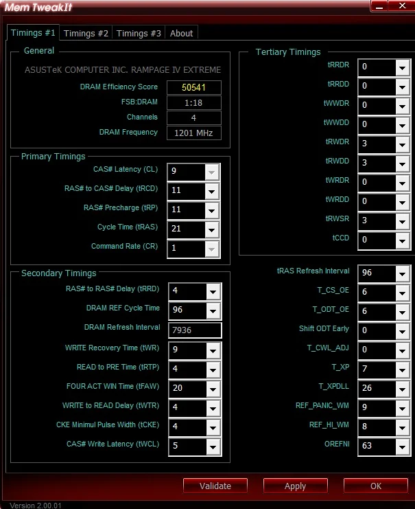

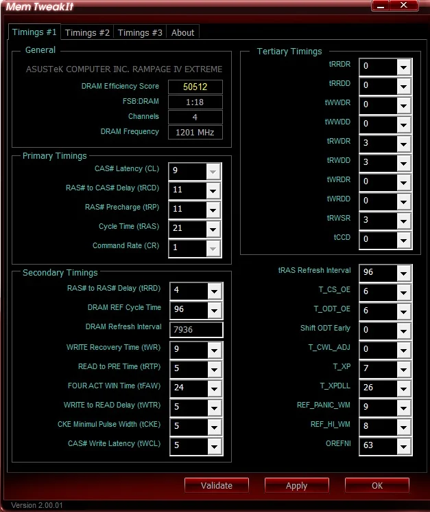

Yep Tone, great memory i must say. Not sure if it's worth that much mind, but it just works so well. I think i might be able to lower TRTP, TCKE to 4 and TFAW to 20. Will try that. Not sure about TWTR to 4 as last time that caused instability. I'm running the dims close to 1.7v hope that's ok for 24/7. Think they're about 1.675v-1.68v atm.
Efficiency score isn't really a realistic performance gauge. You can wack down the refresh interval on some sticks to silly low and it will give you a huge efficiency but the performance will be slower.
Also I found c8-9-9 to be slower than c8-10-10 at 2133
One of mine died at 1.7v but don't let that stop you :p
I used to run my sammys near 1.7v, so I'd like to think these sticks are up to it? They're under warranty so as long as im not being overly dangerous with them, im happy to run max of 1.7v for 24/7. I always really like the idea of 4.8ghz with 2400mhz memory for 24/7, but it needs a lot of vcore on the cpu. Over 1.45v i believe. :(
