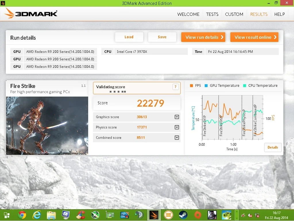

Ok Firestrike @4.8ghz nick, 17,300 Physics. Might be able to improve that a few more points when i bench proper. Not sure if this is good or not.

I'd say thats good matt, i get around the same with my tridents in with cpu at the same clock, with these ripjaws running dual channel i'm getting around 18,000
So you get less for quad channel? I just ran it and scored 17,281 exactly. I will have another go and see if it goes up. My gpu score has gone down a few points though, not a lot but a few.

1.48v for bench runs is probably the max you want to push IvyE on warm water, not Sandy! Sandy is good for a few notches more :p
http://www.3dmark.com/3dm/2680262?
for comparison, same ram as you, but Ivye also has the OPS advantage. I'm not sure what timings I was using for that run, but the VDIMM would have been no more than 1.7v
I tweaked a timing and scored 17,341. Will run it once more time and then move on to extreme.
I think i will be looking at around 17,500 maximum, maybe a bit higher if i get a good run @4.9ghz. I do wonder actually if i used all three red slots rather than the black one if i would get a slightly better physics and combined score. That was how it worked on my P8Z77 WS board with a PLX chip. Using the PLX lanes only got me a boost, at the expense of a slightly lower gpu score. Vice versa for using the cpu pci-e lanes.
I'd be happy with what you're getting for the clocks used. Kaaps Physics IIRC is around that at 5ghz. The fact you're coming in close to mine at practically the same clocks goes to show how you've timed up those sticks. The difference between our scores will be the higher OPS on my chip clock for clock

Got my score up a bit more with another two tweaks. The timing i mentioned earlier i can't touch or i get instability, well for 4.8 i had to increase that another notch to 6. I forget the name but i mentioned it earlier. Lowered two other ones either side of it a notch this time.
4.8ghz
2400mhz
290's 975/1250
Yeah FS is a good test for memory efficiency. Have you checked what bandwidth you're getting?
Yeah i did, i scored a bit lower than you but not far off. Will rerun and post it later. I beat you in one or two of the cpu cache things just.
