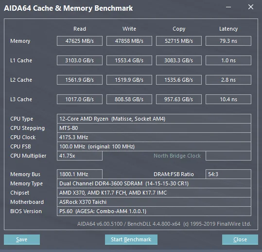

On my x570 IF seems to be happy running at 1800 so ram speeds and latency are good:
