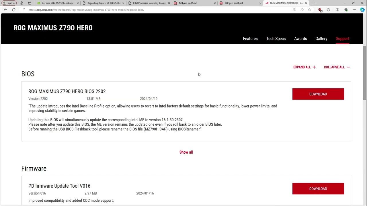

You might want to watch Buildzoid's videos on the subject, he has a CPU that fails Cinebench at 'stock' too.
Good watch this, learnt a few things for sure. It's definitely a little different to my 12700k in regards to how it actually operates. My temps aren't bad but not great either on a custom loop it still hits around 83c on R23 where as my overclocked 12700K would hit around the same temps. I did try a quick game last night on Ghost of Tsushima and it was sitting around 60ish so slightly hotter than my 12700k but as to be expected. The cpu was definitely not thermal throttling as i had hwinfo open to monitor that. I am slightly questioning whether the contact frame i reinstalled may have been a little too tight hence the issues... but again despite that, it should at least be able to run R23 and R24 without problems at stock if temps and voltages are in line.
