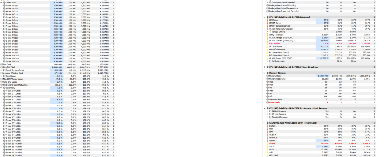

not touched mce, only tweaks are as above. I am on a ddr5 board @6400@Griff7520 - I just thought about MCE, do you have that enabled..? I'm not sure if I should disable mine..? Perhaps by doing so I'll see the single core get to 5.6.
They are similar, as is our approach for the running of the 14700k, albeit you have a Z790 board and yet DDR4..?
Yup, that was it. Damn, I do wish that BIOS defaults are not inclusive of overclocking type enhancements. After updating the BIOS that one slipped passed me, disabling MCE. Now it boosts to 5600mhz as it should.

@Griff7520 Now I can see your sig I can note the DDR5. Then again I should have figured that with the Z790 board. I reckon that MCE must be disabled for you to allow the 14700k to clock at 5.6. Mine is doing likewise now, now that it is no longer using MCE to boost all cores to 5.5ghz.

as I said above, they are the only tweaks I have done. MCE is deffinately enabled@Griff7520 Now I can see your sig I can note the DDR5. Then again I should have figured that with the Z790 board. I reckon that MCE must be disabled for you to allow the 14700k to clock at 5.6. Mine is doing likewise now, now that it is no longer using MCE to boost all cores to 5.5ghz.

Interesting, as mine will not boost to 5.6 on my Gigabyte board when enabled. By default it is set to Auto and that is on.as I said above, they are the only tweaks I have done. MCE is deffinately enabled

All of my settings are done manually, I had missed the disabling of MCE, for the way it seems to work with my Gigabyte board.

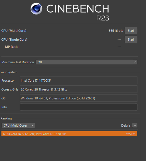

Are you referring to the 4 Ghz E-Core and 5.1 Ghz P-Core when running Cinebench?I just can't wrap my head around why the cpu won't clock to its specification and any sort of adjustment or locking clocks will cause a crash.
I still feel its been degraded in someway and missed QC.
