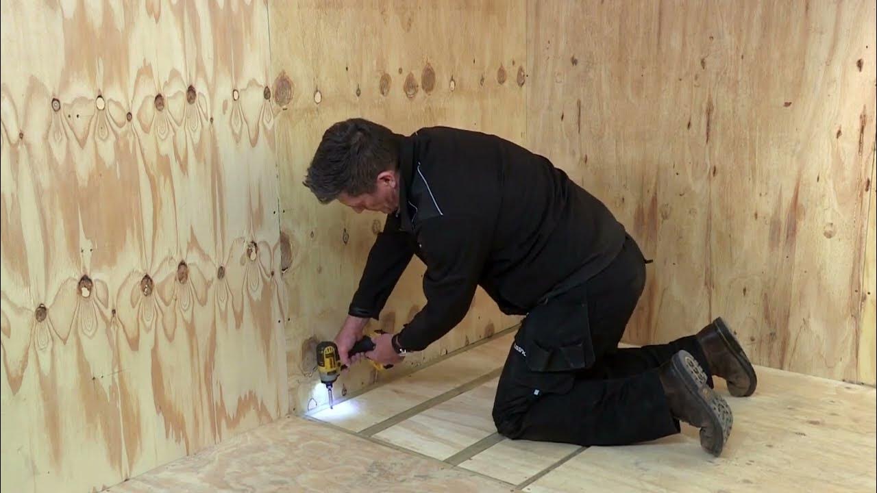

I've used marmox and jackoboard and aquafix but they're all pretty much the same product (the boards that is).
40mm shower tray may present you issues, if you sit it on joists suitably braced then you'll need to raise the rest of the floor by about 20mm, when you add tiles and adhesive you will end up with a decent ~35mm step into the room.
For idea and bracing.
Brill thank you. @200sols the 35mm sounds a bit of a non-starter; is it practice to adjust the joists/reinforce them? Or use a thinner tray?
There is quite a thick carpet outside of the room so I have some flex....
