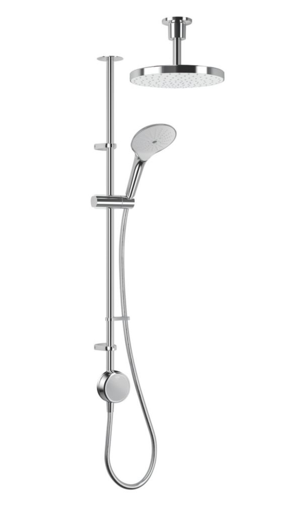

Right, started to get bits sorted now.... For the shower I am thinking this:
It gives me ultimate flexibility as I won't need to install till the very end, and all of my plumbing is in the attic already.

Shower you posted looks nice!
