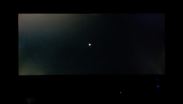

Unfortunately my first two units had extremely bad backlight bleed, mainly the bottom left corner and the second one also had a dead pixel in the central area. It seems like this is quite a common problem with these LG 21.9 ultra wide monitors as a number of users on various forums have reported the same issue as well as a few of the 34" model owners... This third one is a lot better but still not "perfect", however, under normal conditions, the bleed & IPS glow is not noticeable.
My first monitor @ 20% brightness:
Second monitor @ 20% brightness:
The photos make the bleed and IPS glow look worse than what it really was like. It was mainly the bottom left that was very noticeable even during daylight usage.
I contacted LG directly for the second one to see if they could repair it rather than me doing another RMA and getting an even worse one, however, their response was an absolute joke, essentially they told me to "only use the monitor during the day and with a low brightness", needless to say, I cut the guy off there and proceeded to sort a RMA out with the retailer.

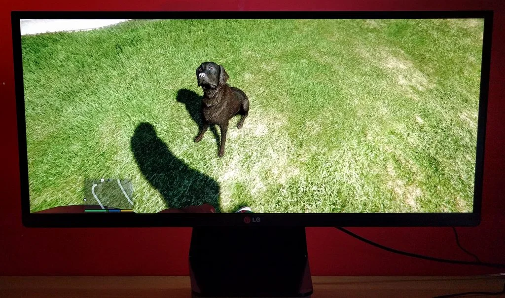

The monitor looks absolutely gorgeous overall, due to the bezel free edges at the top and sides (as in no plastic chassis sticking out), the front looks very sleek. My only complaints with the aesthetics are; the LG symbol AND "LG" writing at the front, only need to have the one there, not both... and the glossy plastic finish, I still don't know why manufacturers insist on using glossy plastic these days, it just looks cheap and is a finger print magnet, give me a matte finish any day of the week!
Underneath the power LED, we have a directional joystick for controlling the OSD, which in my eyes is better than having 5+ buttons to use like you get with DELL monitors. The OSD menu is nicely laid out, it is easy to use and best of all, there is an option to turn off the power LED. Although some sections could be better organised.
The rear ports on the back face outward, which I much prefer to downward facing ports, I find it much easier to connect and disconnect cables. We also have VESA mounting holes (75x75)
The stand is very basic, you only have angle adjustment and two height choices, with the max height still being a bit too low, a box will fix this though :p Dell still have the best stands out there.

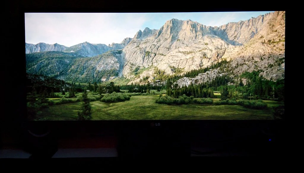

Image quality:
Unfortunately, my camera will not do this screen any justice so you will just have to take my word!
Out of the box, the screen looks well calibrated already although it is far too bright but then they did have the brightness set to 100%...... the cinema preset mode looks more accurate though, I will go into this more later on. I think the right side of my monitor is a bit darker than the left side.

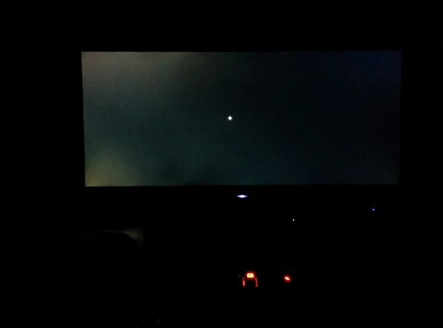

A photo/snapshot from a video of a black screen @20% brightness, once again, the camera makes the bleed/glow/blacks look worse than what it really is, the top and bottom left is IPS glow as if I move the camera and my head more towards that area, it disappears, if this was bleed, it would remain visible no matter how I view the corner.

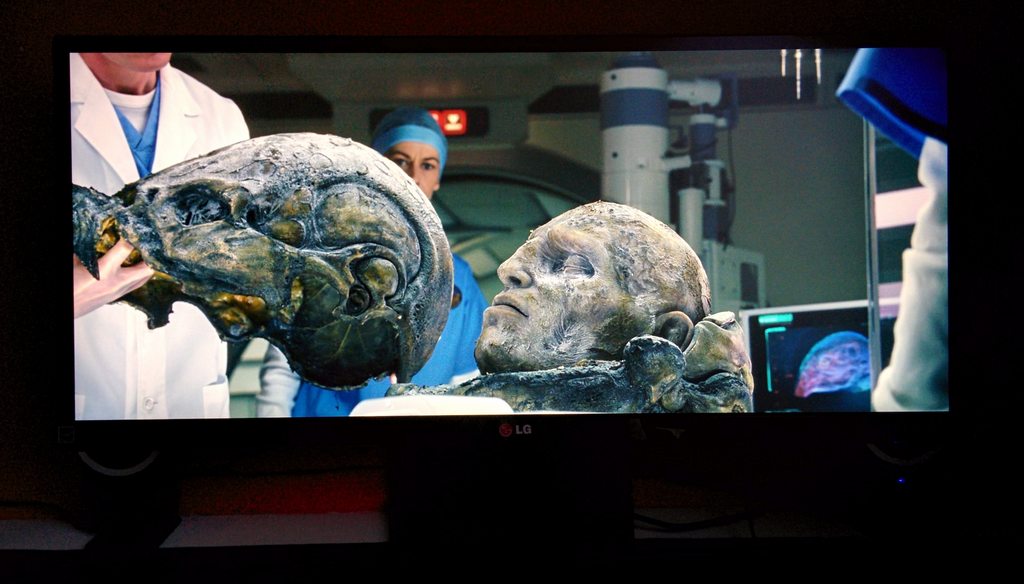

The screen looks absolutely amazing, it is extremely bright, so much that I have the brightness set to 10% and my PC/monitor sits right beside a big velux window too.

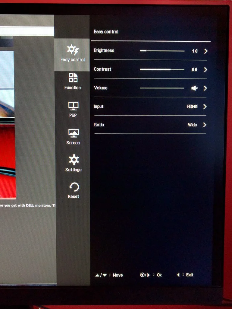

After much testing and tweaking, I have found a brightness of 10% and contrast of 66 with everything else on default except colour temperature set to custom to look the most accurate to my eyes. I have set my brightness to 10% in order to achieve an ideal contrast ratio. Whilst the official specs state a "50000000:1" contrast ratio, with proper calibration for "normal" usage, this is impossible for an IPS display, you can expect the contrast ratio to be between 1000 & 1400 on this particular model, remember all panels will vary slightly though.
Cinema mode is probably the best preset, however, I find it to be too aggressive on the gamma and contrast, the two other presets are awful; game mode is far too blue & photo mode over saturates the colours especially red.
The anti-glare coating seems really good, not too aggressive and not too light, the clarity/sharpness is very good (virtually no grainy look to it), definitely better than my Dell U2311H anti-glare coating.

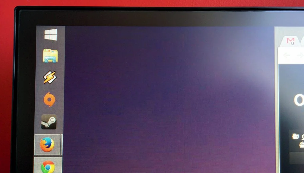

As usual with good IPS panels, the viewing angles are great. The top left of this monitor is quite bad for IPS glow on a black/dark screen though once you view it from the right side.
Also, the "warm up" time from when you first turn the monitor on is very short i.e. it is very bright within milliseconds, with my Dell U2311H, it would take a few minutes till the brightness was at its peak.

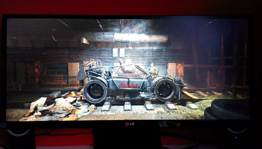

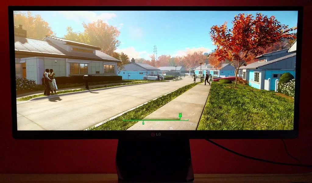

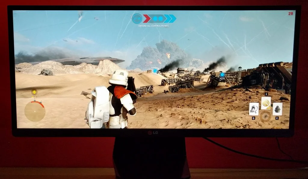

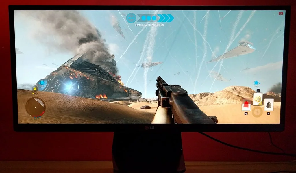

The area where this monitor really shines and the sole reason I bought it is because of films, the majority of films take the full screen up so no black bars that you get with 16.9/16.10 screens. Of course there are a number of films that aren't shot in the 21.9 aspect ratio i.e. Ant Man, however, with the right media player, you can zoom in, this works pretty well for most films and the quality, sharpness still looks great especially if you sit further back. Most TV shows will have black bars at the side. With the content that has black bars at the side, the video image will be the same size as a 23" 16.9 monitor.

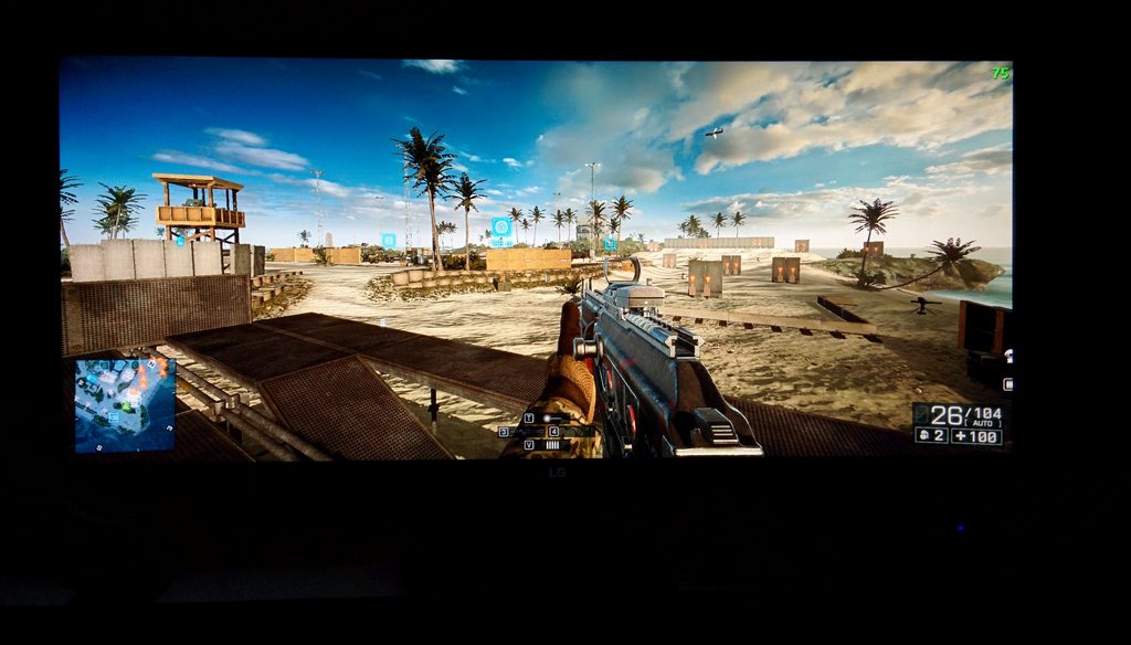

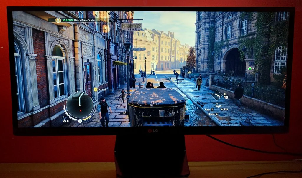

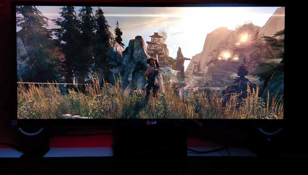

The majority of games also work well with the 21.9 aspect ratio. Some will have no problems at all where as others might have a few issues i.e. cut scenes & menus, the screen will go back to 16.9 so black bars at the side and the UI/HUD will still be in 16.9 format i.e. Assassins Creed Syndicate and GTA 5
Thankfully there are a few games that have no HUD or have been developed with 21.9 in mind, some might require a bit of messing around in cfg files though i.e. Fallout 4:
As you can probably tell from that last photo of BF 4, you also get more FOV at the sides, which is superb for vehicle game play, especially when flying jets. Not much of a MMORPG or racing gamer but I am sure that those sort of games would look even better on this monitor.
You can enable the 21.9 aspect ratio via file tweaks with most games that don't support the aspect ratio out of the box.

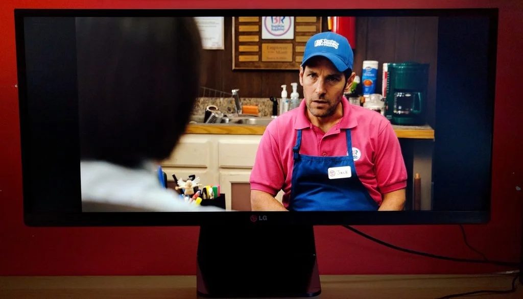

Now this is the only other area that is rather disappointing, the majority of youtube videos out there will have black borders all the way around the actual video i.e.
There are a few videos, which support the 21.9 aspect ratio though.
Thankfully there is a superb chrome extension to fix this issue.
