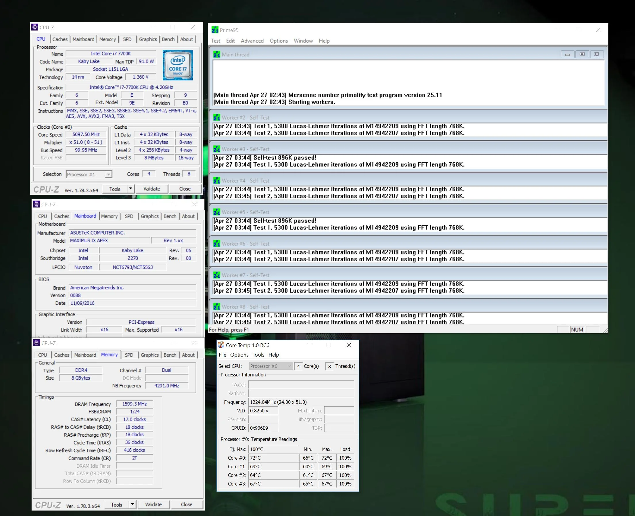

what sort of temps should I be seeing round abouts stock delid?
I can check later, but around 60 degrees with average cooling when running prime v26.6 I'd guess.
Here's mine @ 5.1ghz / 1.376v - temps are ~65 degrees

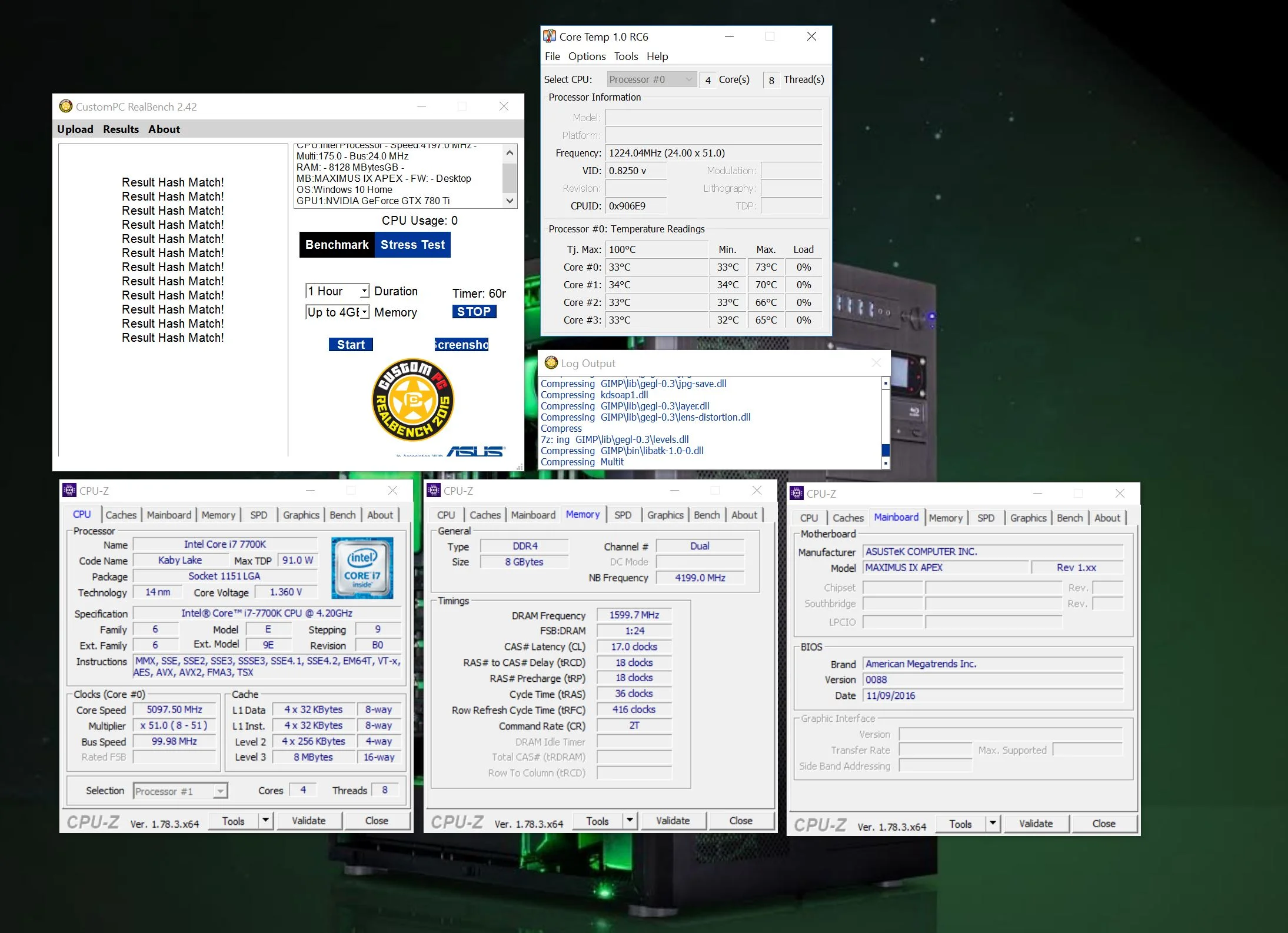

So here is Saintjimmys CPU which fixed and tested myself on AIO 120mm. I guess voltage may go lower I did not tune just guess and its fine straight up for 5.1ghz. Jimmy only ordered a straight up 5G so added value here!!

Saintjimmy paid for 5ghz but as I have said before 5.1ghz is very often possible on these CPU's as can be seen on the screenshots. We under promise over deliver.
