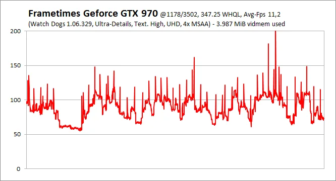

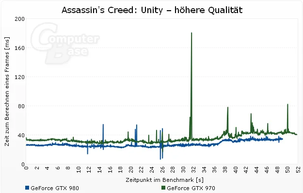

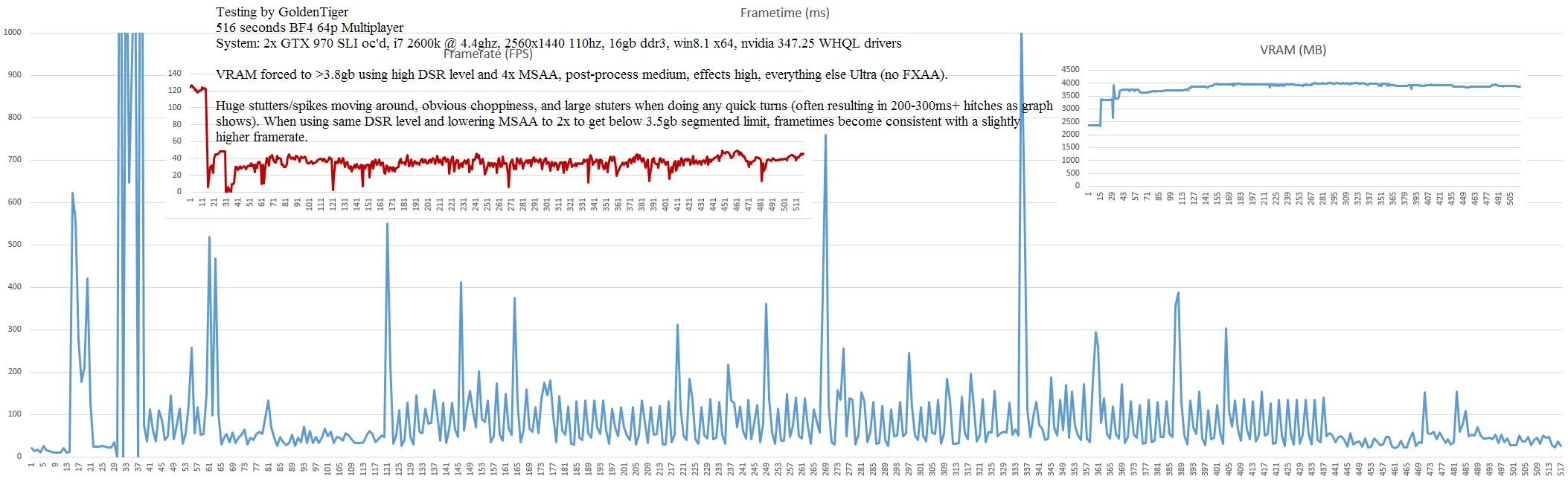

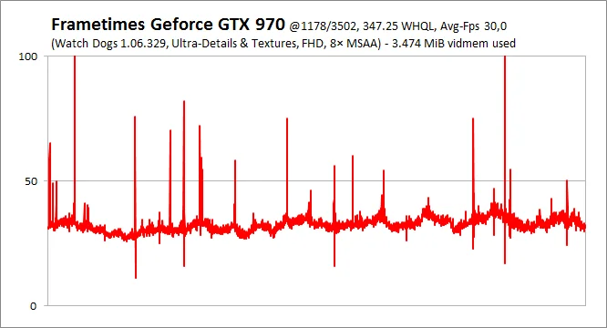

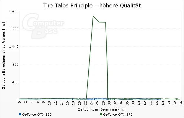

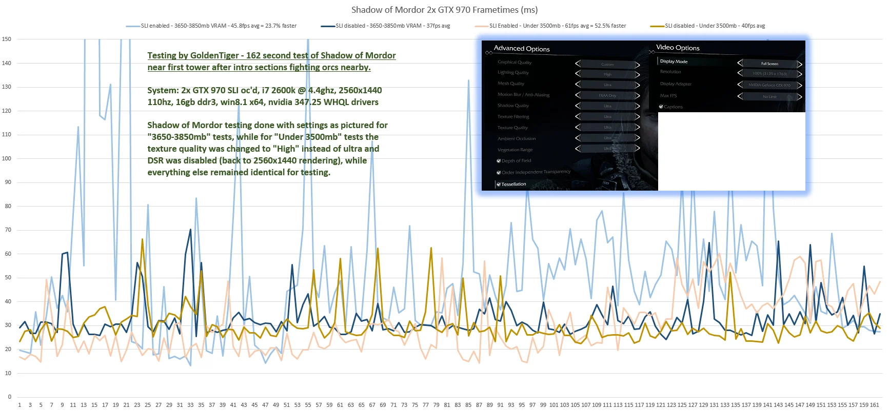

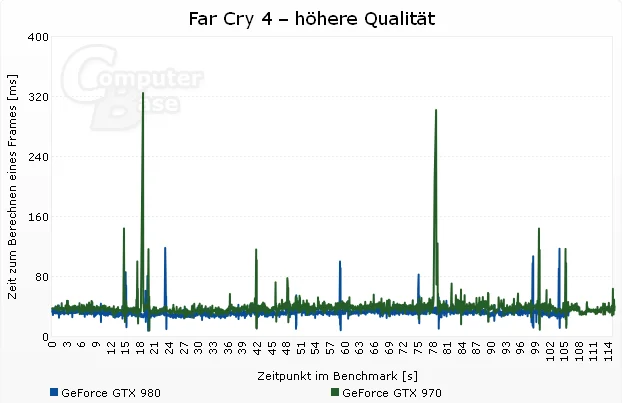

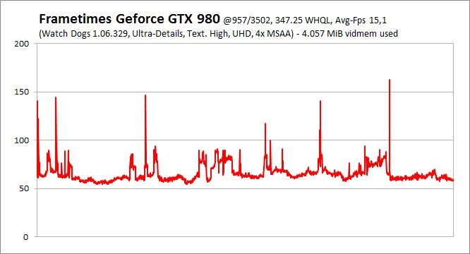

I have to jump in on the above, though, as it is really misrepresenting the 970 issue and you keep posting it repeatedly. The problem isn't the framerate, it is frametimes and the resulting stuttering that comes from the card desperately trying to stay in the faster 3.5 GB section and/or letting the game use the full advertised 4 GB of RAM. That practically stalls the GPU as it has to wait for memory data. New games, and especially upcoming ones, use more and more RAM for various reasons (unoptimized ports, true graphical improvements...). What required ultra high and slow setting before to up the RAM usage is becoming the norm at lower demanding settings and resolutions. There are already reports of games @ 1080p slowly increasing the RAM usage and hitting the 970 troubled 3.5-4GB region. 970 either has to act like a 3.5 GB card or suffer from its limitations.
There are numerous test with latest drivers and game patches, as well as older ones, showcasing the 970's issues. There are also comparisons with downclocked 980 to the same computing power as the 970 and illustrating the deficiencies of the gimped 970's memory configuration that doesn't show in the fully enabled 980 which 970 was advertised as matching.
Again, I would like to thank you for your excellent support, but please stop downplaying a problem that is very real.
Here are some of the examples:

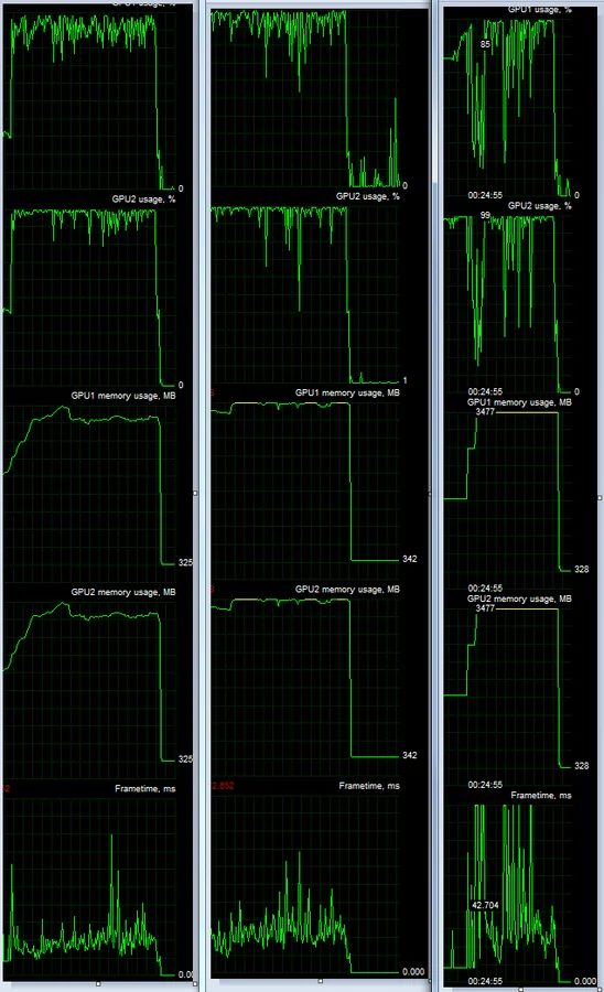

Assassins Creed Unity test:
4690K @ 4400
GTX 970 G1 @ 1595/7400
Two runs, about 8-10min each, did some parkour in the same area (tried to stay into populated ones), killed some templars, helped some guys being F*ed up by nvidia...i mean...thugs, opened some chests, all of that.
First run at 1440p and second at 1080p. All settings besides resolution remained the same.
note: on the 1080p run I opened the menu twice, hence the two frametime spikes (the menu is pretty damn heavy). On the 1440p run I remembered and kept it on game play all times.
