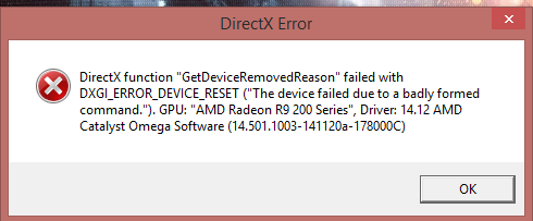

Yeah I noticed performance was... underwhelming to say the least and Mantle doesn't work at all. I was getting around 90fps at 1080p with everything on Ultra. Seems like Crossfire isnt working with BF4 either...
I get the same directx error too, it only seems to be occur in DA:I and BF4. I'm fine in mantle though. Is it something to do with the frostbite engine? Because I can play borderlands fine in directx for hours

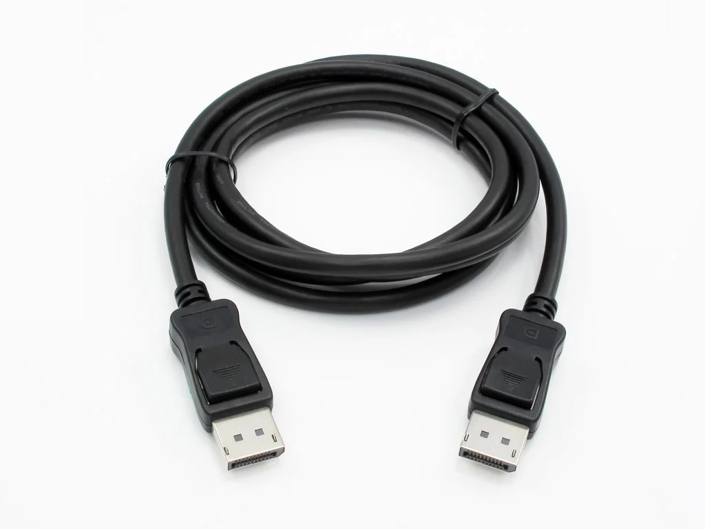

Ok, I've come across a very bizzare issue, I have no idea whats going on.
Got a replacement displayport cable today, and discovered that the new cable will only work on displayports 2 and 4 on the card.
The old cheap cable works on all 4 displayports....
If I connect the new cable to ports 1 or 3, then I get a constant "connected" and "disconnected" sound playing. Like it will connect, then immediately disconnect, and repeat that until I unplug it. No display at all and no dialog on the screen. Just blank.
Very bizzare, because the cheap cable works on all ports....
Once I connect the new cable to a working port, I have this message on the screen:
The system has detected a link failure and cannot set the requested
resolution and refresh rate of your Displayport display. Your display
might not support the requested resolution or there may be an issue
with the cable connecting the display to your computer.
Im stumped... Card is obviously not faulty because the cheap cable works fine on all ports, but the new cable cant be faulty either because it works fine in ports 2 and 4.... wtf?
The cable is a Monster Digital Life Displayport Cable
Looks like this:

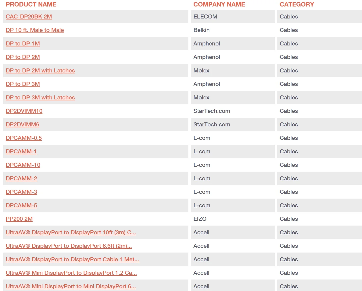

We recommend people use only cables that are on the Display Port 1.2 certified cable list. Is your cable on there?
I'm currently using one of these, Accell UltraAV B142C-007B DisplayPort to DisplayPort 1.2 Cable with Latches (6.6 Feet / 2m) which is in the list. :)

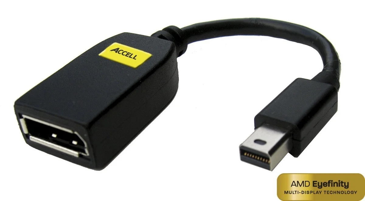

I see yours has a minidp connection on one end. Since getting my 295x2 i needed an adapter too, so i again went with an Accell B112B-001B 10 Inches UltraAV Mini Display Port/DisplayPort(f) Adapter - Black pictured below. This is also on the certified list. :)
I don't have any of the issues you described, so this would be my first port of call. :)

I originally planned to get one of those because I looked up all the "certified" cables that you mentioned.
The reason I didn't get it was because theres apparently nowhere in europe that stocks them right now. Amazon will apparently have them in 2-4 weeks which is a bit silly.
I also discovered that there is apparently no such thing as a "Displayport 1.1" or "Displayport 1.2" cable, and that, according to Displayport.org, all Displayport cables are compatible with all Displayport capable devices.
Despite what you may read, there is no such thing as a DisplayPort 1.1 cable and DisplayPort 1.2 cable. A standard DisplayPort cable, including the so-call DisplayPort 1.1 cables, will work for any DisplayPort configuration including the new capabilities enabled by DisplayPort 1.2, including 4K and multi-stream capabilities. All standard DisplayPort cables support RBR, HBR (High Bit Rate), and HBR2 (High Bit Rate 2), which can support 4K at 60Hz, or up to four 1080p displays using multi-stream.
