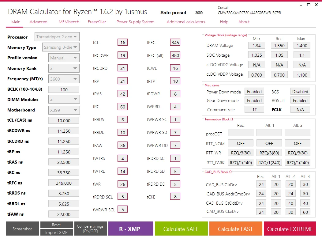

Yeah i got my timings from Ryzen DRAM Calculator but it's not much help for this memory/platform (doesn't support "Calculate Fast" and only goes up to 3466) so i also try random stuff and see if it works lol. I tried 16-16-16-40 at 3466mhz with 1.4v last night and that wont boot. I also load the D.O.C.P profile and tweak the memory settings from there. No idea if the Manual profile makes any difference. Haven't had time to test any more settings though, but did you get any lower timings at 3600? I think 16-20-20-42 miiiight be possible...
@MR.B Yeah the latest DRAM calculator doesn't follow support TR40 but I just used it as a guide and borrowed some experience from running the 3900x with half of the RAM. I have not tried 3600 at tighter timings, because CB benchmarks showed it to be 100+ faster than 3200cl14 tight and i'm just relieved to run it at 3600 even loose. BTW I used Manual profile and a safe preset in the calc to get the loosest timings but with the highest chance to work. v1 and v2 profile produce tighter timings that cause lots of errors to crop up fast. Also I am running procODT at 60 Ohms if I remember correctly. If I remember correctly, if I either don't run procODT at 60 Ohms or VDDP at 900mv it won't boot. Running RAM at 1.43v after some memtest errors, seems happy now. Maybe 16-20-20-42 is possible, but I ain't trying :p.
@tommoT.Striker Ohh so that's what V1/V2 profiles do in Calculator, because i tried V1 before for 3400 and had no issues. And if 1.43v can only just get stability then maybe 16-20-20-42 isn't possible without too much voltage... And i'll be running 24/7 so i'm not going higher lol. Did you tweak any other timings apart from the 16-21-21-42 at 3600, or just leave them on Auto? If you tweaked any i'd really appreciate a screenshot if possible because the Calculator doesn't support 3600. BTW i get 13,850-ish in CB with PBO enabled, and without it i scored over 350 less so it's a decent increase and hasn't done much to temperatures.

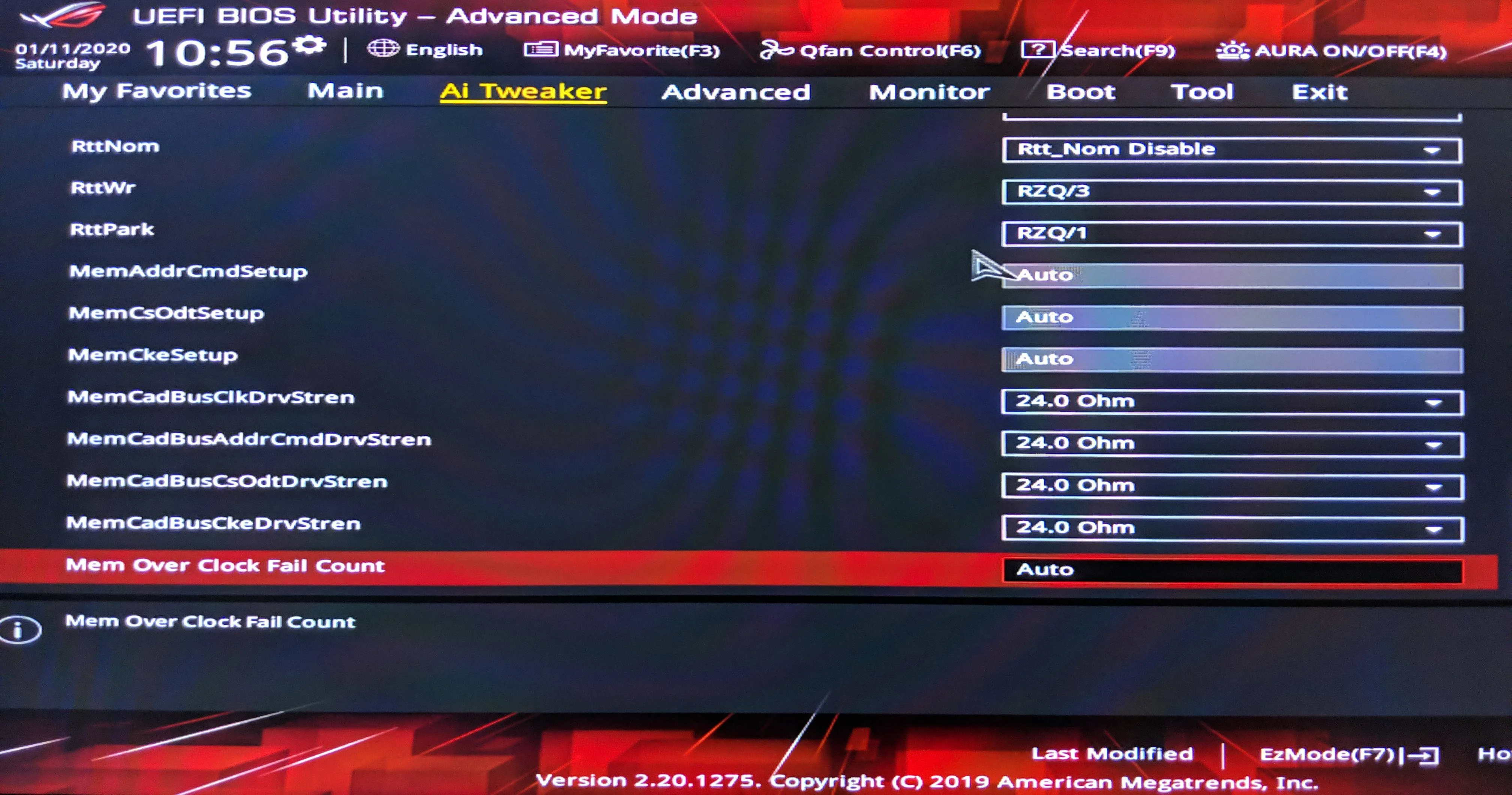

Here you go.
Only thing to note is I got my procODT from setting processor to Ryzen 2, and taking the alt 1 setting there which for me was 60 Ohms. For Threadripper 2 it's blank. You might not have to change yours so you can leave it. BTW 1usmus the next release will support TRX40 boards so might be a big help too. Everything I set to the Rec. values, didn't set tRFC1, 2 etc only tRFC.
Oh set Cad Bus like this:
Set VDDP to 900mv, ram AB and CD to 1.43v. Power Down Mode and Gear Down Mode enabled.

So you used the Samsung B-die setting in the calculator even though this memory is Micron D-die, i didn't know you could do that. I'll try those setting in a few days when i have time to properly memtest/bench them.

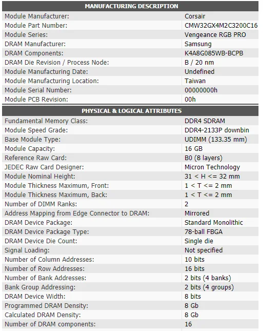

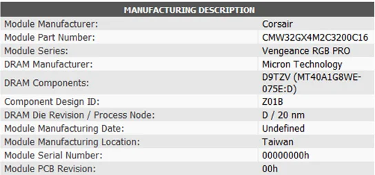

Well, we have found the source of the problem. All four stick of my Corsair are Samsung B-Die, albeit not the best binned. That's why I thought it was fine to up my Ram voltage. Dunno where we got our wires crossed, but I thought you had B-Die too. Here is my Thaiphoon Burner output. I'm guessing yours says Micron D Die @MR.B ?
@tommoT.Striker You also have CMW32GX4M2C3200C16 so i assumed the dies would naturally be the same. I checked the boxes too and it's definitely that model. Seems like Corsair have changed the memory dies but kept the same model number, which is really dodgy...
That is dodge isn't it. Cheeky as. And there is no real way of knowing what is inside. I got CMW32GX4M2C3200C16 and CMU32GX4M2C3200C16 three years apart from different stores, one is White LED, the other RGB and they're both the same bdie chips.
Yeah Corsair can seriously F off with that. You got lucky in the silicon lottery because even cheap B-die is still better. DRAM calculator also says "not supported" when i select 3600 for Micron D-die so i'm not even going to try CL16 at 3600 because i can't see it ever working now. I'll probably just use 3400 or 3466 with 16-18-18-36 :( at least it only needs 1.35v.
